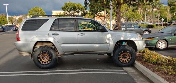

I just installed 225/75/17 Goodyear Duratracs with a 2" front and rear lift. One thing to keep in mind is, these older trucks most likely have sagging stock springs. A 2" lift looks like a lot more than that when done. BTW, I do get a little rubbing on the front mud flaps and fender liners.
This was right after the tire/wheel install
That looks good! Which lift are you using?
