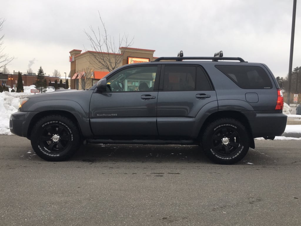

I just installed 225/75/17 Goodyear Duratracs with a 2" front and rear lift. One thing to keep in mind is, these older trucks most likely have sagging stock springs. A 2" lift looks like a lot more than that when done. BTW, I do get a little rubbing on the front mud flaps and fender liners.
This was right after the tire/wheel install
Setup looks good!
If I may, I'd like to offer a solution to your rubbing issues. As I have 285/70-r17 MT's on my 4th gen with 3" of "lift," I've had rubbing issues for months and finally don't have that issue anymore. First, I took the mud flaps out from both the front and the rear. I also, cut so much plastic in the front wheel well with a razor blade. However, the best upgrade to my rubbing issue was the body mount chop. The trails I ride have a good bit of drops and dips, so pushing the tires inward constantly. The BMC has eliminated that issue entirely.

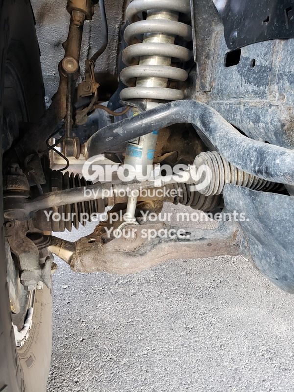

You can do more then 3" of lift. Just make sure you use a spring. Here is a pic of my CV's. I have the usual diff. drop. Toytec 2.5 springs and a 3/4 spacer (1.5 of spacer lift), so around 4" of lift. Also note my UCA are fairly straight.
I had FJ springs and a 2" lift spacer before and everything was more drooped. I tried a 2.5" lift spacer before that but it was real bad and my CV would click at full lock. About to change to a heavier taller OME spring tomorrow and use a 1/2" spacer which should have me at a solid 4" of lift.

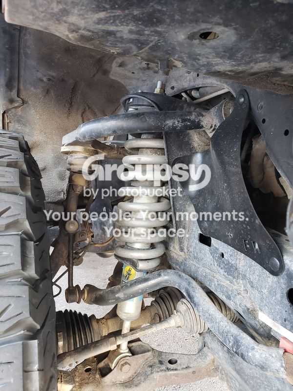

Where you had to cut a little off the bottom to get them to sit right, correct? I read that too and made sure the 2007 OEM FJ springs I was looking at weren't the ones with the issue, and they weren't. Fit was perfect. Here's a pic of my old springs before removal. The end of the spring fits up against the stop, so it's easy to understand why there's an issue if the coil is a little too long.
These are the old and new (to me) springs (and one of the 4600s waiting its turn for installation).
It's not visible here but the bottom end of the FJ coil fit right against the stop exactly like the stock 4R coils did.
