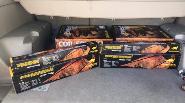

After a lot of back and forth for a couple weeks between Bilstein, Icon, Dobinsons. I paid a visit to Slee Off Road to pick up my new suspension lift from OME. It will be going in tomorrow! Extremely exited
Would love to see pics of your final product. I'm still in the hunt for my suspension so I'm curious to see how yours turned out.

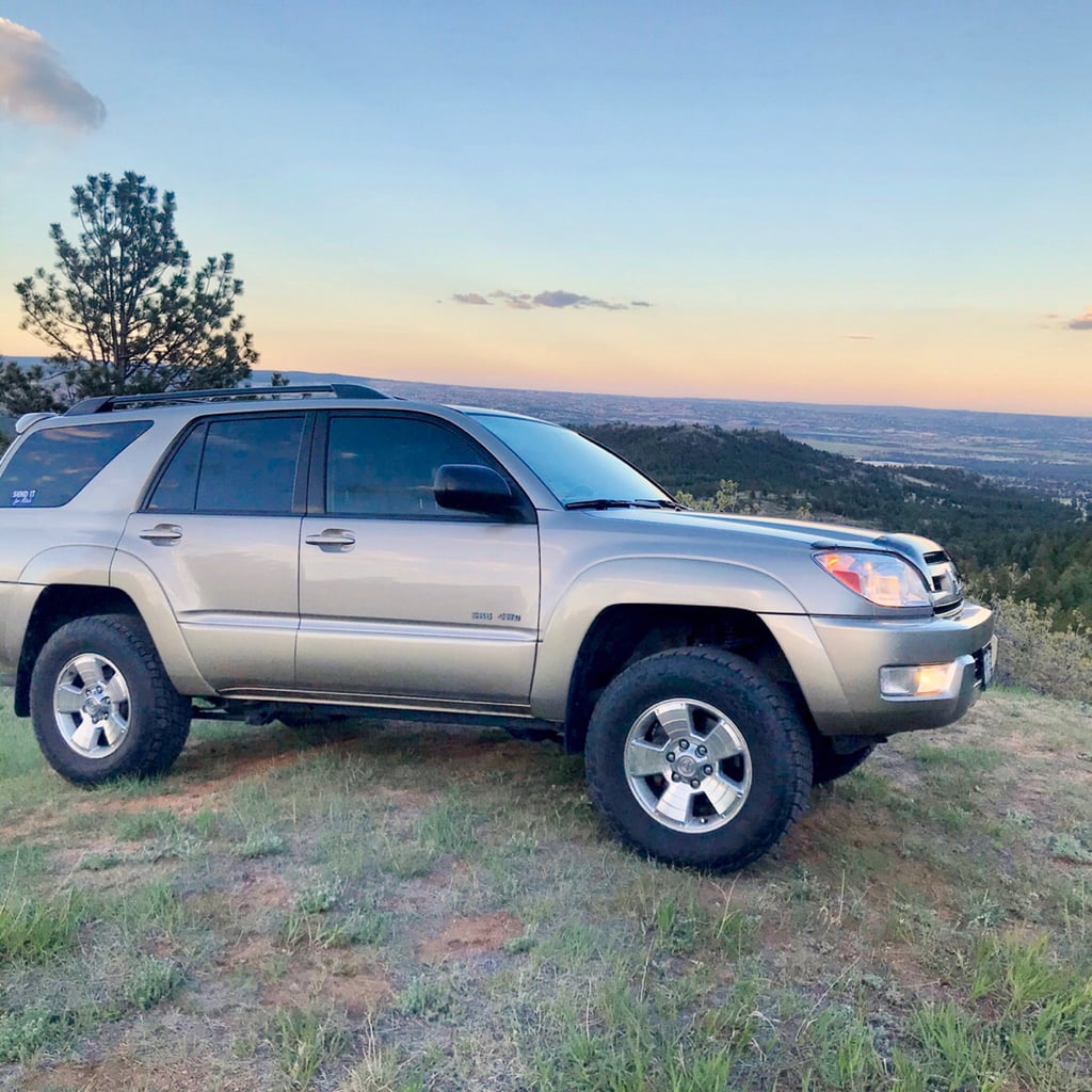

It drives way better than stock. This is with only the front done So far. I installed the rear a couple days ago but don’t have pics yet

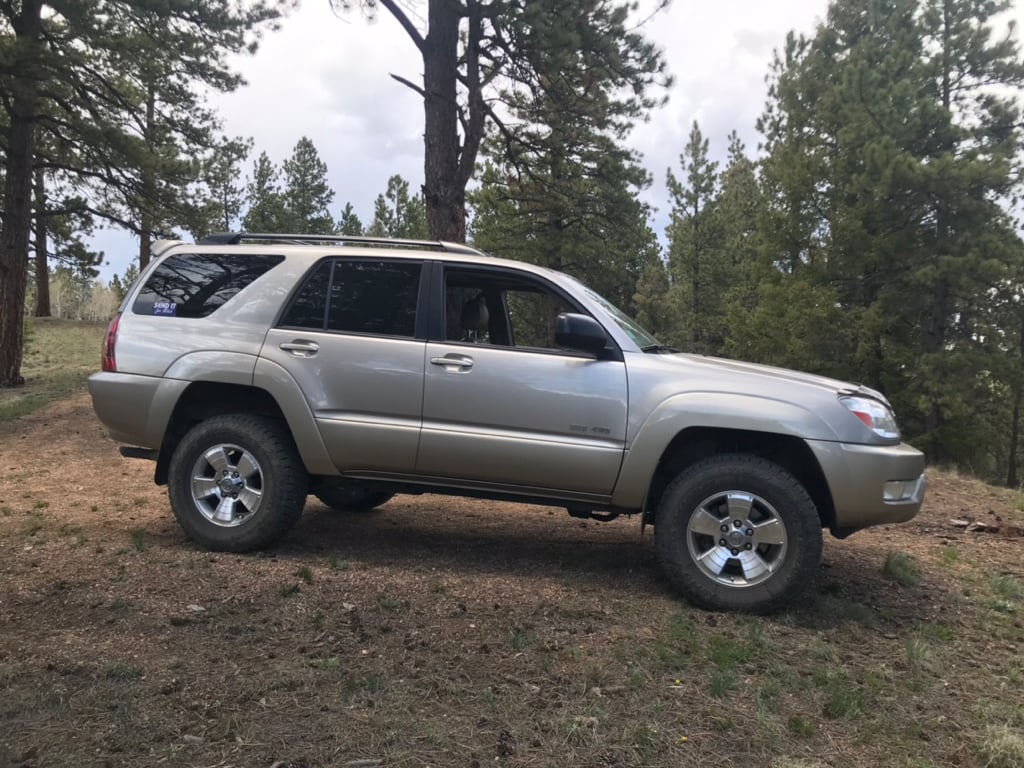

Here she is in all her glory. The OME set up got put through some serious abuse these past couple days and they’ve held up extremely well. I am impressed at how they eat up the impact off road. We had a family emergency while on a trail yesterday and we headed down a little faster than we should’ve, hit some rough spots that would’ve completely destroyed the stock set up we used to have. 10/10 for OME.
Looks great! Did you do the 3" lift or the low lift 2" package? Also, what size tires are you running?
I did the 3” package, the rear springs are rated for medium load since we off road a lot but rarely pack heavy
