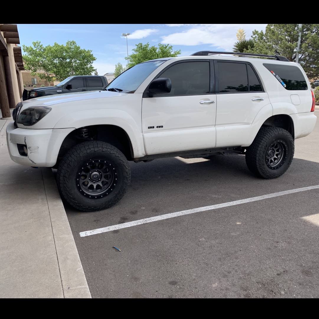

With that mild of a lift and -10 with 285’s you’re gonna have to chop the mount. It sounds like a bigger deal than it is. Any shop that isn’t trying to gouge you should only charge about $30 to do it. If you’re unwilling then consider smaller tires, I’m not sure if 275’s will fit as I’ve never run them. I have the Ray 10’s in the -38 and 285 AT3W’s and they took quite a bit of work to make them fit.
