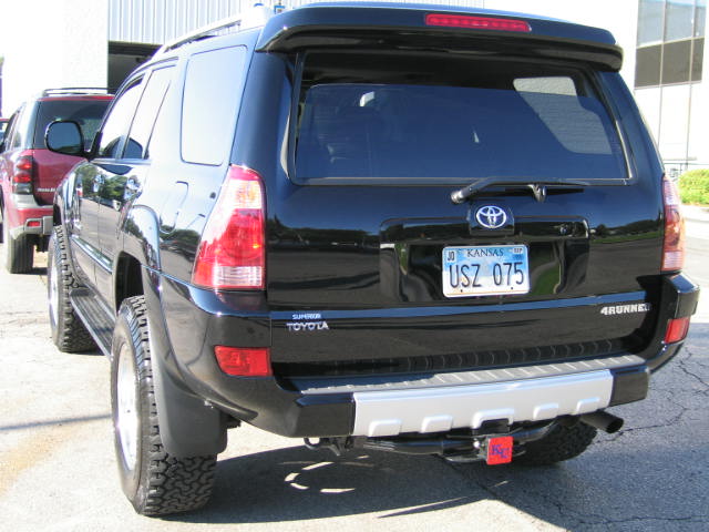

I've had many, many people do our spacer lift in conjunction with the Bilstein 5100's. I can't finds the posts on here as they are several pages back, but what customers have said is, with the Bilsteins set at 0 or almost 0 with our 2/1 kit installed, it rides BETTER than with the Bilsteins set at higher or max. This is good to know, and if anyone else wants to try this, let me know. Kits are on sale, but I'll help out more if I can if anyone else wants to try this.
Lift & Leveling kit Holiday Season Sale!
Kits currently shipping same day usually, with 1-2 day express shipping. A few other customer installs:
Also can do any custom size you want.

Hey Jason,
What set up is on that first photo of the black 4runner? Bilstein 5100 set at 0, stock springs, and how big of a spacer up front? I think that's the perfect look/height that I'm looking for. Thanks.
