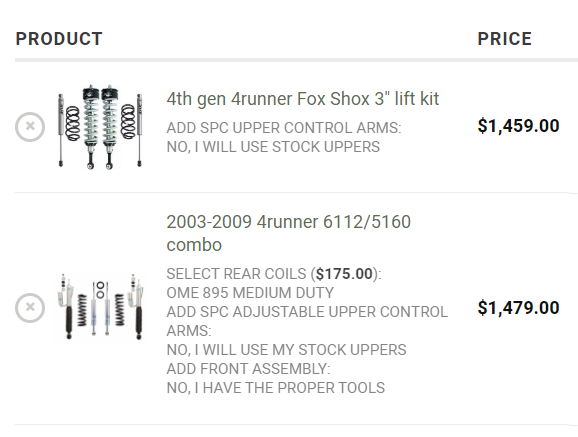

How do i choose one?!
Someone please help me choose one or the other!
