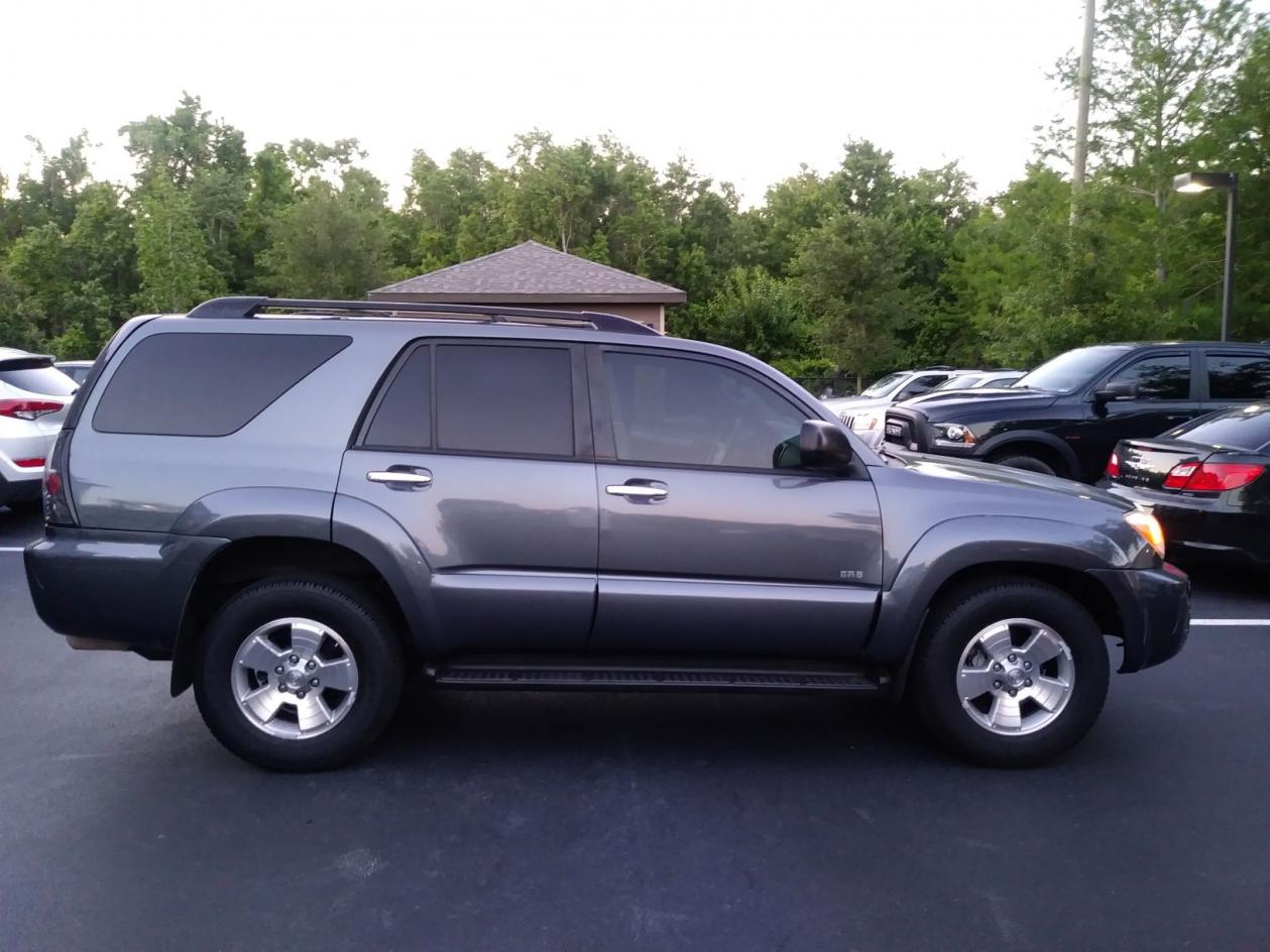

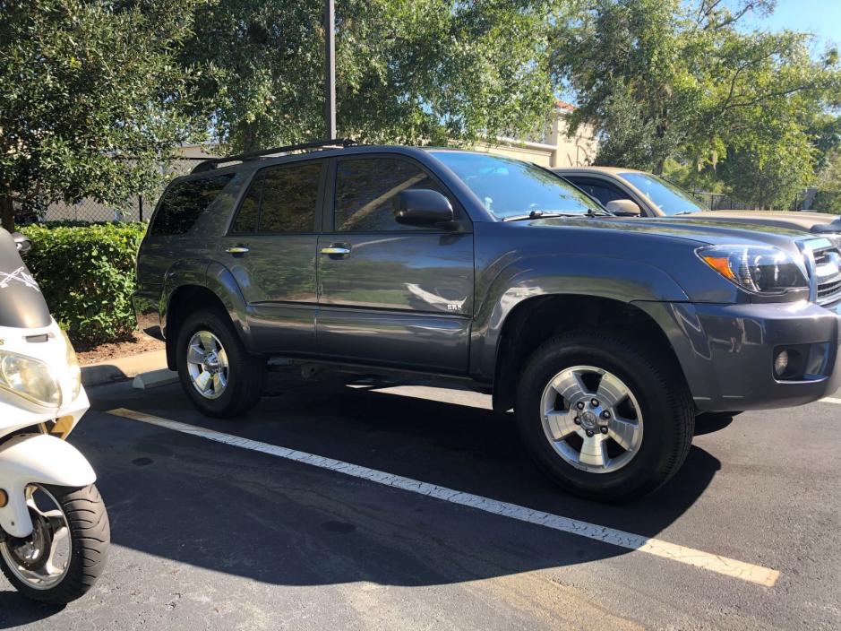

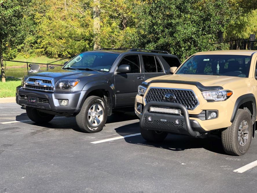

So a buddy and I installed 2016 Tacoma TRD suspension in the front of my 2006 2wd V6 today, finally! My 4Runner has almost 170k miles so I am pretty sure the stock stuff was sagging a bit, but with that being said I got right about 3.25" of lift from where it was, which gives it just a slight front rake. I have the rear Bilsteins from the Tacoma also, so I'm thinking some springs to lift it about 1" in rear would be perfect. Any suggestions? I'm thinking Bilstein B12's or Eibachs.
EDIT: Here is a pic of the 4Runner originally, and now (the rake seems a bit exaggerated due to the slope of the parking spot), and now next to a neighbor's 3rd gen Tacoma TRD. Rubs a little at full-lock, and you can see some slight positive camber, so definitely needs an alignment soon, but it drives straight and smooth down the road.
