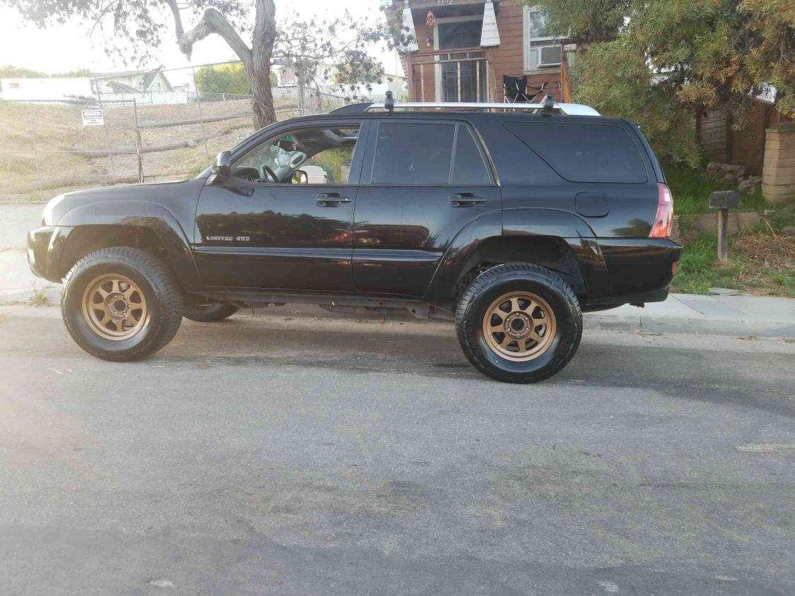

I got 2.5" out 883s with a v8. Matched with wheeler T13 out back with netted about 1.5".
This picture is how it it's right now with 265/75r16 Falkens. Hope this helps and doesn't just add to your confusion.
Did you need to add UCAs and a diff drop?

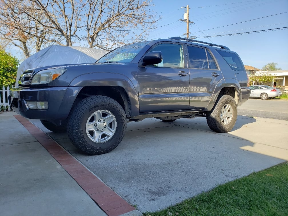

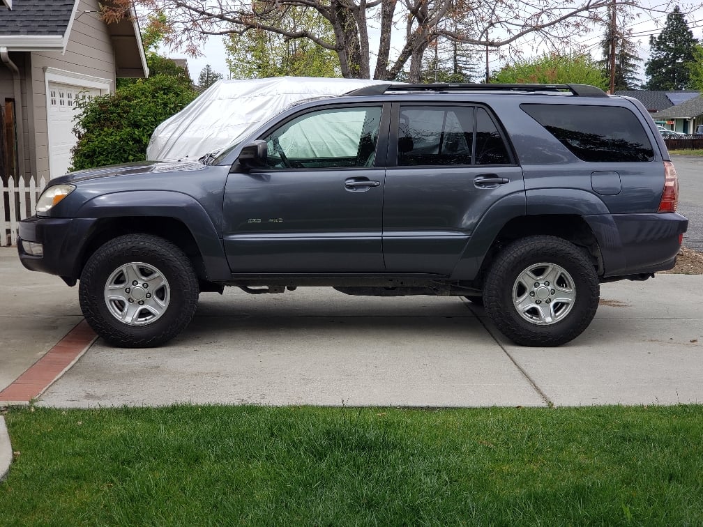

well, I’m kinda back to square 1 here in this thread. right before this whole coronavirus shut-down hit I placed an order from Wheelers for a set of Bilstein 5100s, with OME 2887s for the front and t12 springs for the back. my goal was to do a mild lift of around 2” on my 2004 v8 and go up a tire size to 265/70/17s.
I bought the 887s based on a conversation with a Wheeler rep, who said I’d yield 2”-2.25” with a V8. then I saw this gent’s post in another thread:

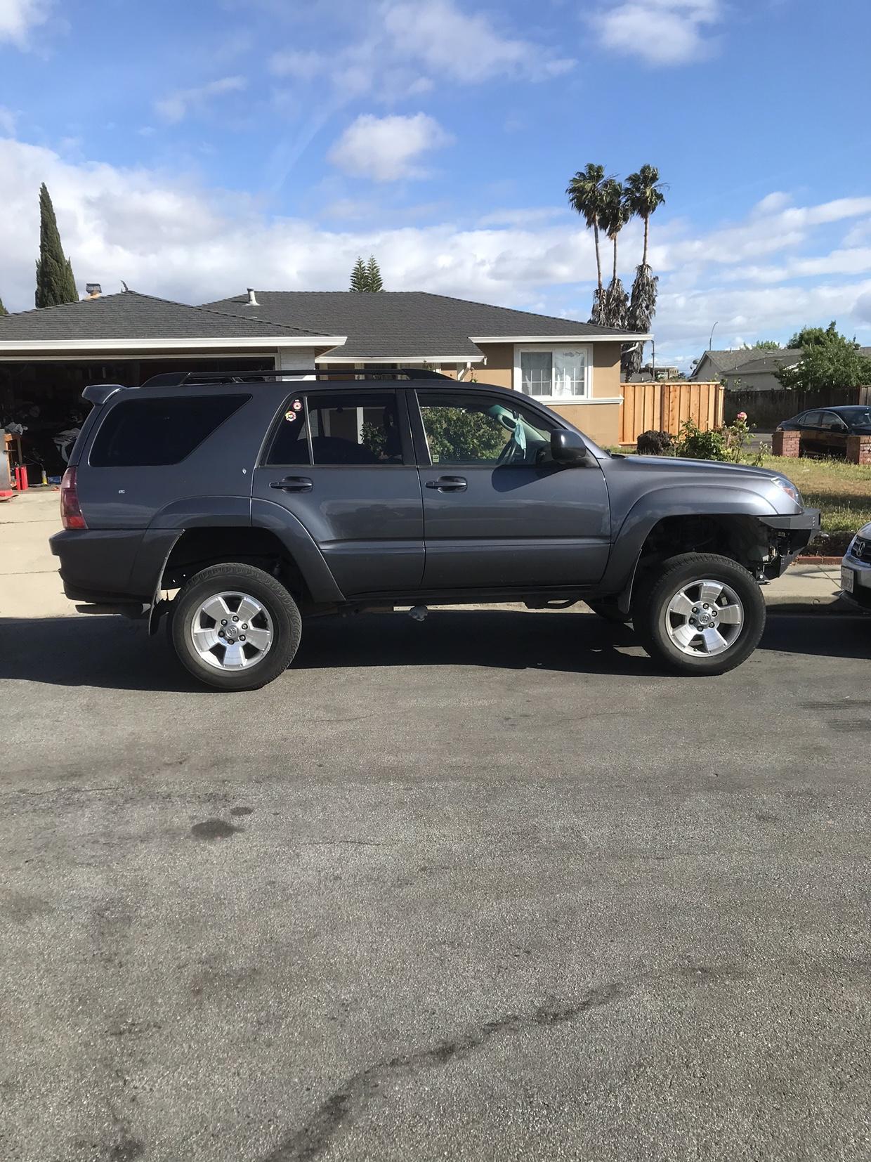

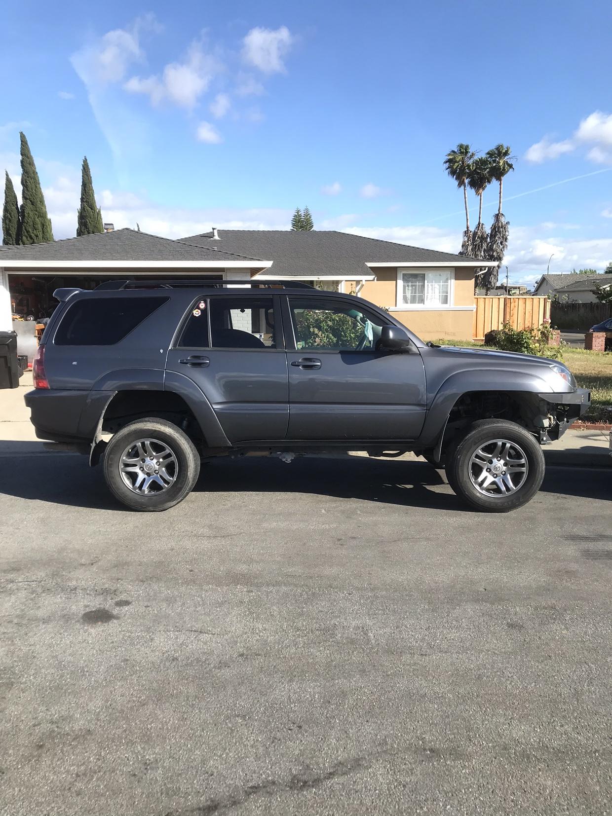

Teasing the sequoias on the rig I have spacers on right now. Gonna wrap in 285/75/17 falken AT3s.
Both wheels have 265/65/17 for reference.
He’s also running 5100s with the OME 2887 springs. That’s way more lift than I was expecting and looking to do.
Thanks to a couple of other users (@eleven14 and [MENTION=204425]The-Wood[/MENTION]) I realized I’d gotten bum advice from Wheelers and will now have to wrangle with returns. I have pretty limited knowledge in this area (obviously). Since my 4runner is still on original shocks and springs, I bought the fronts pre-assembled. I’m looking for a front spring recommendation from people with experience: still looking for a mild lift and would like to avoid messing too much with replacing parts etc. due to the change in height.
note: I previously read through this entire thread, thought I had good info, now feeling a little lost again. Looking to get it right this time. Thanks in advance for any insight!

do you know if he used 0 setting on billies? Cos according to specs you should get around 2-2.5" with v8 and 887
