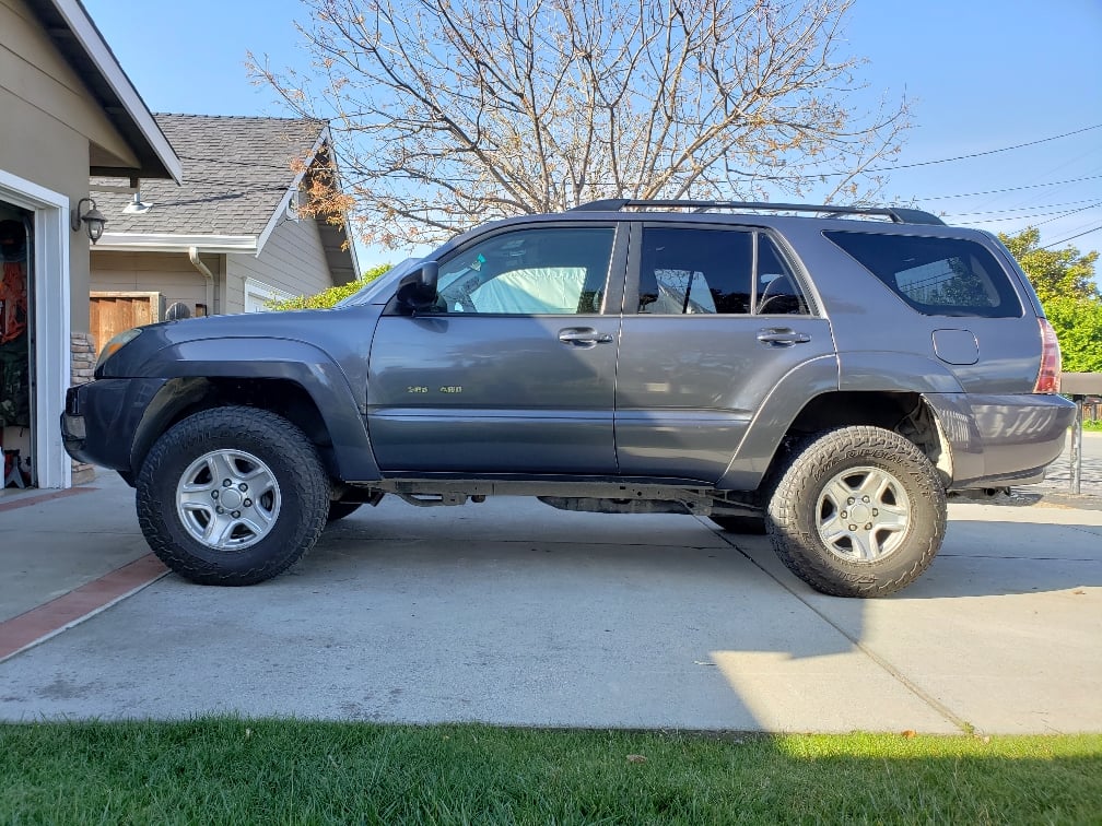

This picture is mine befire I lifted it more with a 1/2" spacer up front on 265/75r16 Falkens.

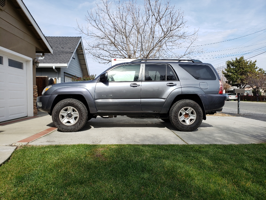

Notching up the stock worn out coils with the 5100s made the ride too rough. New shocks and springs make it ride awesome!
I have this setup right now. Very happy with how it turned out.
OME 883 front
Wheeler T13 rear
Bilstein 5100s
Hub to fender 22" up front and 23.25" out back.
Sitting on the same 265/75r16 Falkens.
