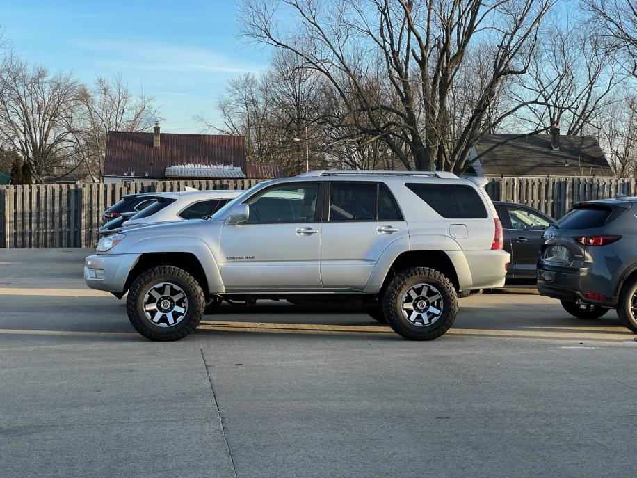

2003 Limited V8. Bilstein 5100 all around (lowest/stock perch setting on front), OME 887 front springs (used, already settled), Toytec Superflex rear (new, not settled), 5th gen TRD Off-road wheels, 285/70/17 Falken Wildpeak MT tires. Stock UCAs. Only rubbing was front fender liners. A little massaging with a heat gun and we are good to go.
