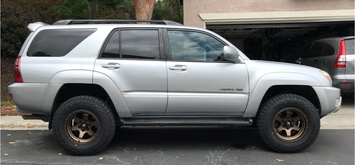

Below, the gray 4Runner has the OME kit installed. For comparison, the black one beside it is a stock '04 that I also own. Both have 17-inch tires and stock wheels.
Here is the gray 4Runner with the Bilstein 5100s, set at 0.85 inch:

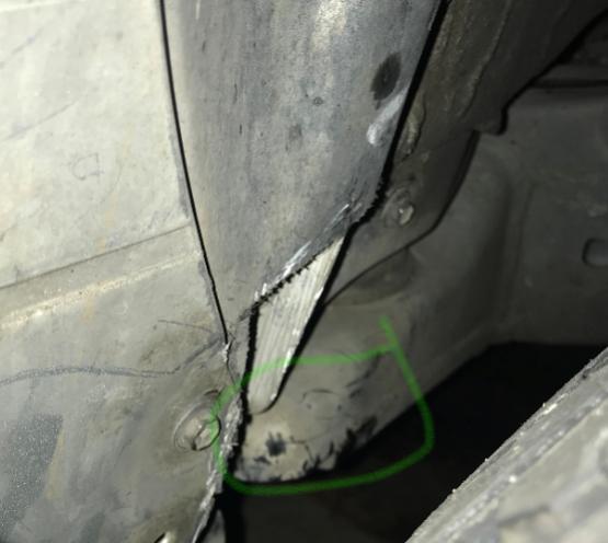

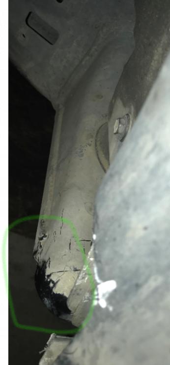

New Rims/Tires and Slight Rub at Full Lock or hard turn
Hi and got new rims Fuel SHOK666 17x9 -12 with 275/70/17 Wildpeaks. There was slight rubbing on hard turn even after trimming plastic by mount and moving fender liner. I have 6112 at the highest lift setting but noticed that lift was not as high or 3" or softness of spring might be causing rubbing as well at turn when leaning. I had alignment done and I think Caster was at +3.
I was going to trim Body Mount with my cutting wheel but trying to avoid.
Questions:
1) Is trimming BM 2" without welding plate going to affect frame? I don't have welder. It seems like integrity of frame won't be compromised but every YouTube I saw was adding the plate.
2) 6112 springs seem soft and I thought I saw thread on King Springs to lift but don't know P/N. Will lift help alleviate rub?
3) What is max Caster setting? Mine is at 3 right now and I was thinking to get realigned at specialty off road shop.
Any other opinions or options are helpful.
Mike
