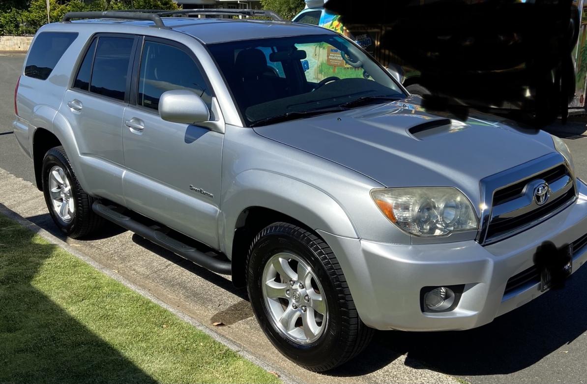

I just happily joined the 4th gen family. I like the xreas, but I want to lift it which would mean getting rid of the xreas. I was thinking of going billstein 5100s. I want to make it as level as I can without any chance of going reverse rake. I don’t hall anything and don’t go off-roading. I bought a 08 sport with 84k miles. Would it be best to go 1.75 in the front with a small spacer in the back? Anyone have experience getting rid of xreas for billsteins? Thanks everyone
Yes, this post has information on the what, how, and why of my choices when I swapped out my X-REAS. It includes links to X-REAS removal instructions too. Good to follow the procedure as you can make a mess at best and hurt yourself at worst if it's not done correctly.
3rd Gen Tacoma front coilovers with low mileage are often available on FB Marketplace at very attractive prices. They'll level your truck or get it pretty close (My front is .5" - 1" lower) and have the huge advantage of being a bolt-on install, meaning you don't have to assemble the spring and shock together.
You mentioned you won't have extra weight on your truck and will be staying on the pavement, and for those reasons you may be happier with Bilstein 4600s. The 5100 is designed for lifted trucks that carry extra weight such as winches, armor, etc. so some feel they're too stiff on a stock truck. I have 2020 Tacoma TRD Offroad coilovers up front and 4th Gen 4Runner Bilstein 4600s on the rear and really like the ride. They're great off-road too if you ever decide to venture out into the wild. Here's how mine looks:
