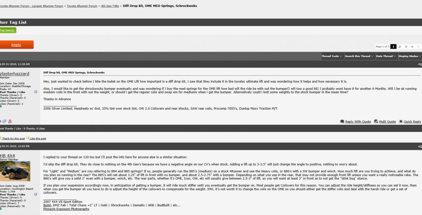

What's the general consensus on diff drops? I bought one from apache offroad with all my other suspension components but after the fact I started seeing that most people don't recommend them.

Anyone?

Not really needed on the 4Runner for most lifts. Seems like 1st gen Tacomas need them more often but even then it's kind of iffy.
I've got around 3" of lift, not counting the 1" body lift and my CV angles are still good.
The other thing to consider is that a diff drop really only rotates the front of the diff down, yet there are 3 main mounting points for the diff. This can potentially start screwing with the pinion angles. Really, they don't help very much in most cases.
Alright that's kinda the consensus I was getting, I appreciate it man!
