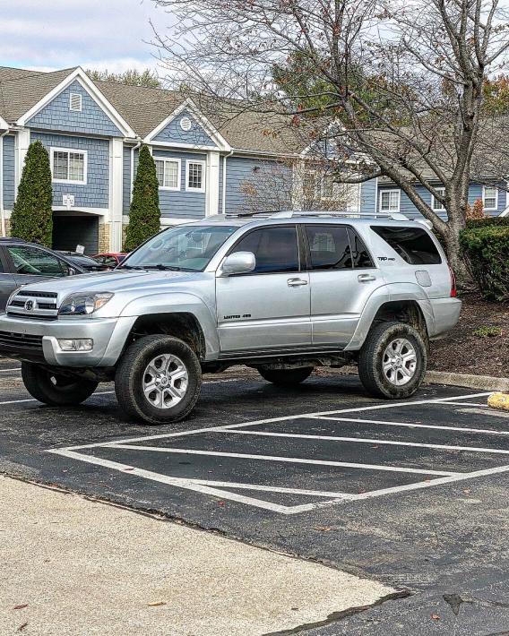

Finally able to get my new shocks/springs on this past weekend.
Bilstein 5100's all around
OME 2886/2896
It replaced the original suspension and the previous owner's 3/2 spacer kit.
Need to replace the 265's with 285's then it will look much better.
(apologies for the terrible quality of the picture.)
OME 2886/2896
Looks SWEET.
