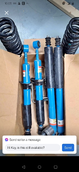

Hi bluesky,. I'm in the same boat as gloch with a sad 2003 4runner needing some updates. I don't have the Xreas to worry about and it's just a stock 2003. Ive found a stock set on FB marketplace as you suggested. (I'm in Canada so the price doesn't seem bad at $300). Since it's both front and rear you say I'll probably only need some different bushings for the rear? They say they only had it in for 1 month.

This is from a 3rd Gen Tacoma? The set I got was from a TRD Offroad edition but the other trim levels should work as well. You will need to assemble the front coilovers, which can be done following one of the many threads on the forum. Bushing info is below. I would also recommend new rear springs but that’s not mandatory.
Rear shock bushings: here's a thread about ways to change the bushings and my post showing how I did it using the Pitman puller method. Be sure to get this one (Autozone p/n 27022). It’s the smaller of the two that they loan. The “jaws” on the larger one are too wide.
