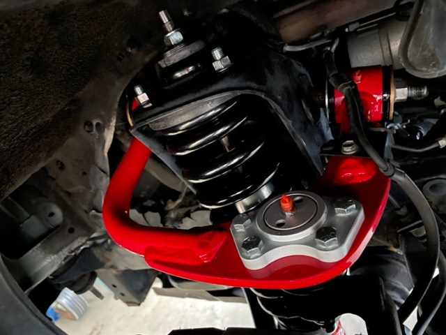

First piece of the puzzle received! Timely dispatch, excellent customer service, and great post-sale care from JBA. Thoroughly impressed with this packaging as well. (These are packed better than a certain electronics box store packs computers.)
Sorry for the low quality pic, I don’t “do” image hosting. (High quality wouldn’t do them justice anyway, haha.)

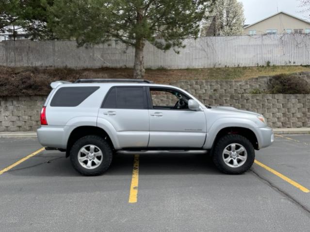

The general rule of thumb that I was taught was: “If it rubs at stock, it’s still going to rub lifted.” Obviously this doesn’t apply to ALL lifts, wheel combos, spacers, etc…
I recently deleted my XREAS system and subbed in the Eibach Pro Truck Lift kit, and absolutely love it. You and I have a bit of a mileage disparity though, as my ‘06 is at 242,000+ So the ride quality was night and day as my XREAS was mostly shot. New ride is much stiffer, (supportive) very noticeable when cornering, but in a very, very good way. (It also eats bumps/holes with little to no transfer; even with my coilovers maxed out.)
Pending your wheels and their offset; you could consider a wheel spacer kit from SpiderTrax to help eliminate that rubbing at steering lock. I used JBA High Caster UCA’s with my lift, and retained OEM wheels; so spacers were mandatory for me without going to a different wheel. (Next year, maybe.)
Utilizing the +30mm offset OEM wheels, and a 275/70R17 tire, I was rubbing my UCA’s passed 180° wheel input. Now, with the spacers; the only rubbing I have is on my right side mud guard, because I binned this vehicle previously and reused the damaged liner affecting how the guard sits in the wheel well. (It’s a bit “bent” lol.)
I don’t do any major wheeling, I live in the flatland of Texas. I wanted a little extra ground clearance, aesthetic lift, and better off-road capability for when I do take it out hunting, shooting, camping, etc. My truck is RWD after-all…
Heavily edited photo attached before spacers were added.

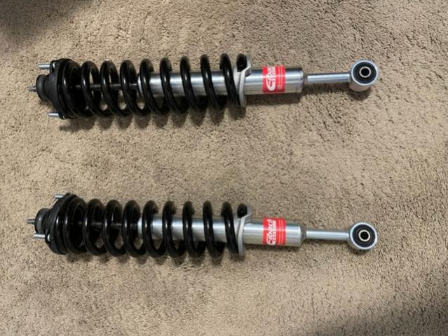

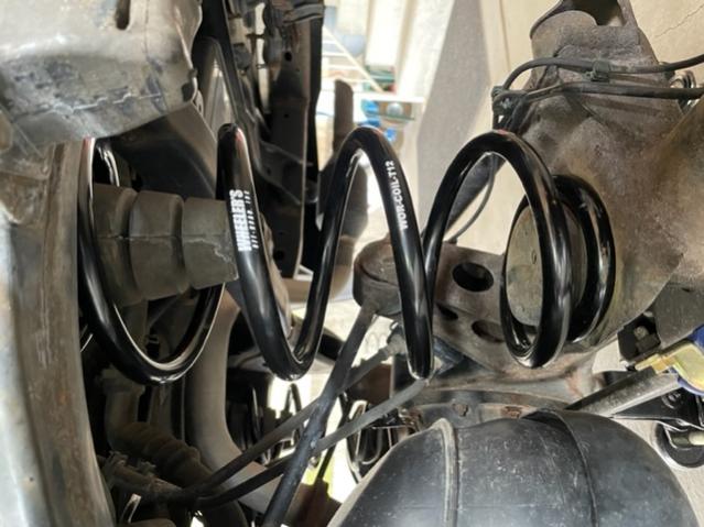

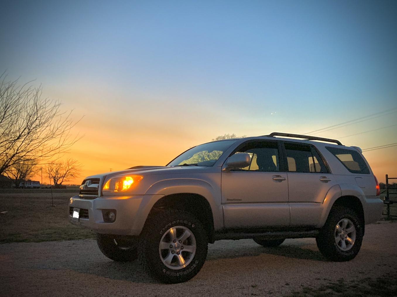

Eibach Pro-Truck/Wheeler's T1/T12 lift installed
New lift installed! Tore out the XREAS and the old 2/1 spacer lift and replaced it with Eibach Pro-Truck shocks and Wheeler's T1/T12 coils. I had Wheeler's pre-assemble the front coilovers (bottom perch); their price for the assembled Eibach shocks with the T1 coils was a great deal and made the install much simpler. I also added a 1/4" topout spacer to the front left. Also went with a new pair of JBA UCAs, and new Mevotech sway bar end links front and rear (2nd Gen links for the rear).
I ended up with the following hub-fender measurements after a couple weeks of driving:
FL: 22 5/8” FR: 22 3/4"
RL: 23 3/4" RR: 24”
That's a good amount of rake in my opinion, with about 1 1/8" on the left and 1 1/4" on the right.
The only significant issue I ran into was the alignment bolts on the LCAs were all seized, so they wouldn't loosen during the install. I had to pry down on the LCAs just a bit to get the lower shock mount in. But when I took it for alignment, the shop was able to nudge the bolts just enough to get it within specs and about 3° of caster. I thought about replacing the LCAs now but I think I'm going to let it ride for awhile and worry about that later - they seem fine as well as the ball joints are ok and there is only just over 125k miles on the rig.
Anyway, it looks and rides great. And as always, I was able to get tons of good info on this forum!
