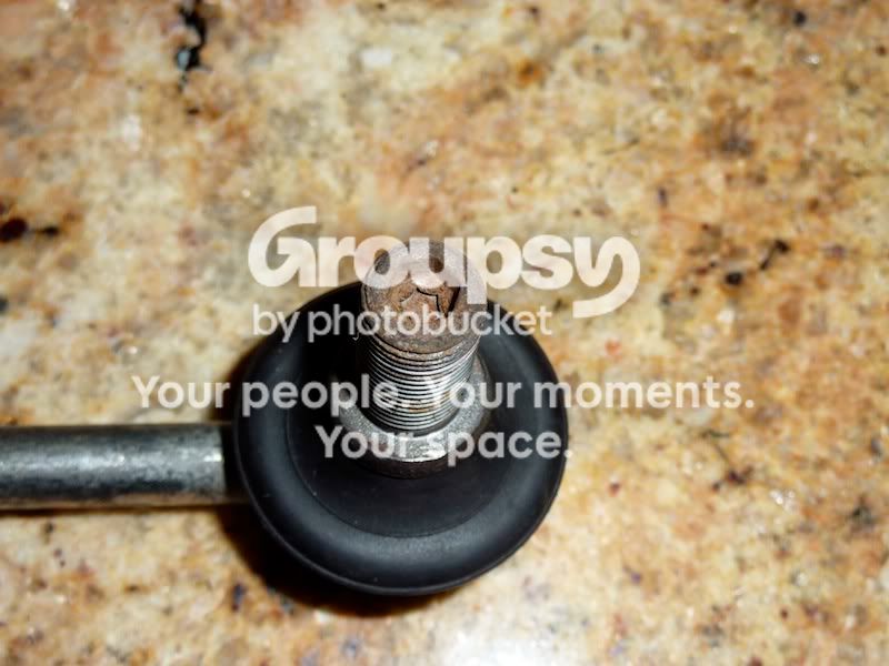

To add to that link,,, if the axle is doesn't drop far enough to slip the spring and spacer in then remove the upper links where they connect to the axle. That will allow the axle to drop lower. You might also have to loosen one end of the panhard bar. Or you can use a bottle jack between the axle and the frame and push the axle down further. Make sure you don't stretch the brake lines.
Also, if you find the stabilizer bar link is just spinning when you loosen the nut. Use an allen wrench to hold the bolt still.
