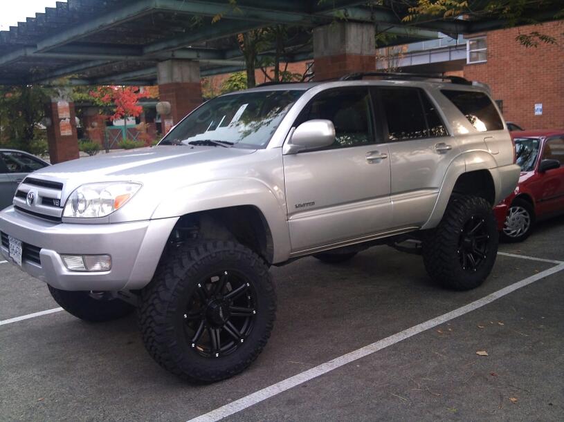

4th Gen 6" lift with 35x12.5xR20
I do really like the write up but it seems like the 4 gen T4R's are very limited to how much they can be lifted.
Here's a pic of what I have, everything under her is custom with alot of machining, cutting grinding and welding. I had the adjustable airbags (RAS) on the back with the Xreas... so there was a lot of cutting and grinding just clean up the axle. I have Bilstein 5100's and long travel leafs underslung below the axle. For the front, I went with a 6" ProComp Kit - the tacoma was too wide and the Fj was too short for the rear supports. I used the Fj kit but alot of custom fabrication just to get it to fit... still looking for a way to fit my swaybars back in, but she rides real pritty as it is.
Next to come are the front ARB and rear CBI bumpers, skid plates, sliders and so on... eventualy I plan to solid axle the front but that is a long way away still.
Here's a pic of what I have, everything under her is custom with alot of machining, cutting grinding and welding. I had the adjustable airbags (RAR) on the back with the Xreas... so there was a lot of cutting and grinding just clean up the axle. I have Bilstein 5100's and long travel leafs underslung below the axle. For the front, I went with a 6" ProComp Kit - the tacoma was too wide and the Fj was too short for the rear supports. I used the Fj kit but alot of custom fabrication just to get it to fit... still looking for a way to fit my swaybars back in, but she rides real pritty as it is.
Great looking truck! Post it up over in the "Lift and Tire Central" as well.
http://www.toyota-4runner.org/4th-gen-t4rs/51742-lift-tire-central-pics-post-em-up.html
What wheels and size are those? Same with the tires. Welcome to T4R.ORG!
