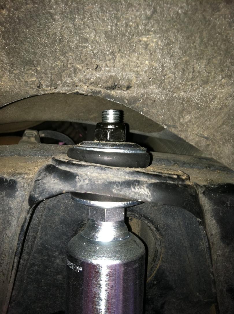

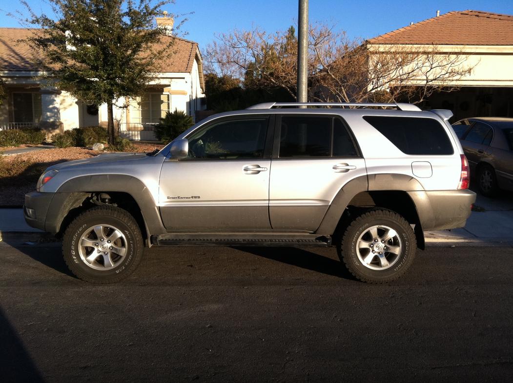

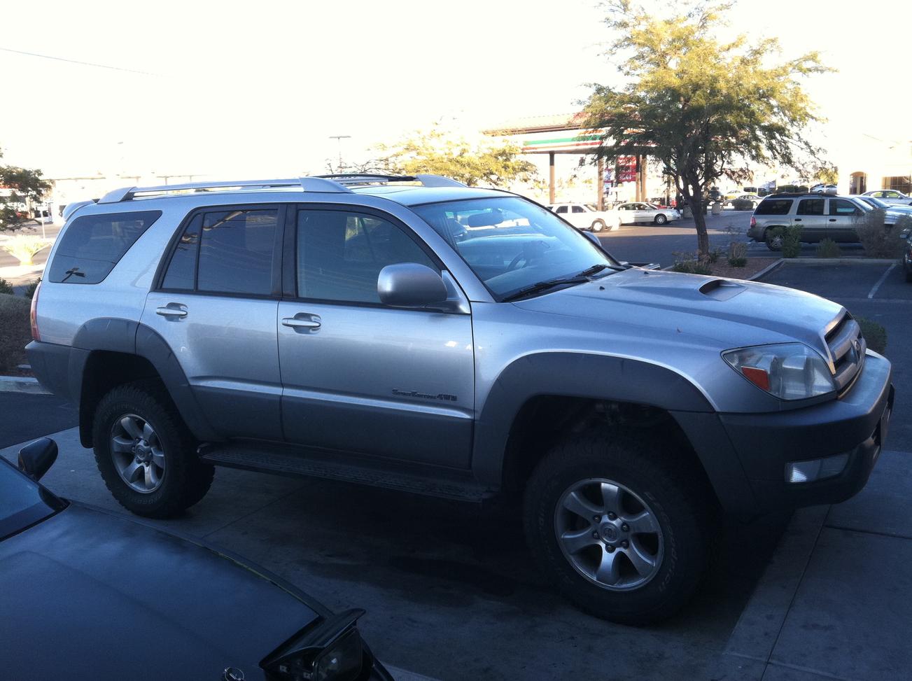

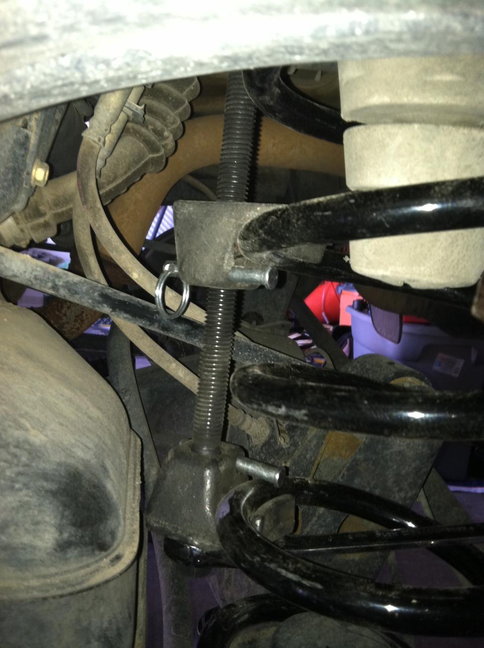

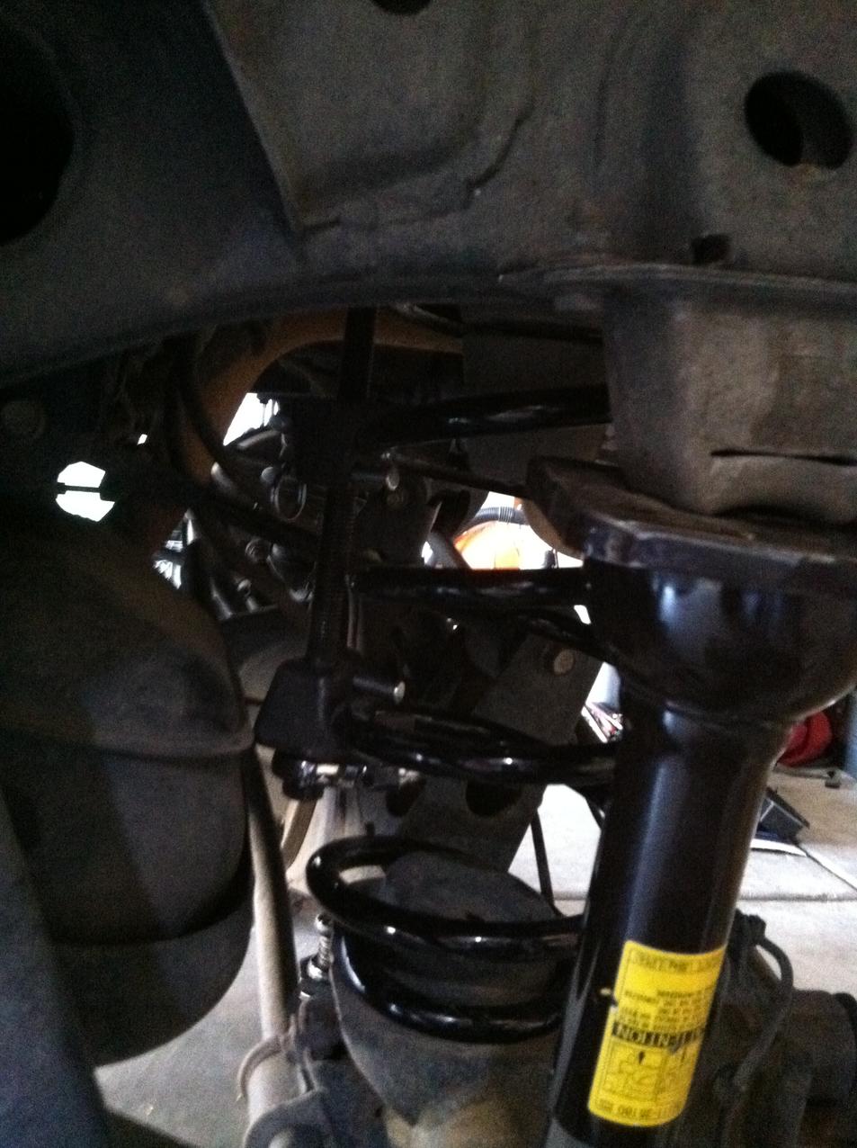

Well for better or worse my suspension swap is complete! I love the FJ springs and 5100's. The Dead XREAS is pulled off and in the trash. :gun5:
No more bumps rattling through the frame.
I left my Day Star 2.5/1.5 on my truck, and that maybe a first. Haven't seen anyone that did that. I am alittle concerned that my CV's are over stressed, but time will tell. I will attach what pictures I have. Also I left the 5100's at the factory setting, zero lift from Shocks. I gained about 1.5 inches with this set up, and I really didn't want that much, suppose I could have figured it out in advance with more research.
Other notes:
* The Spring Compressors from Autozone worked just fine for me.
* I did not take off any pan hard bar or sway bar on the rear.
* Developed a small hole on the drivers LCA Ball Joint, very little info on the net on replacing this unit or the dust boot
* I used the eccentric drop method and it really helped
* Did take off the swaybar...helped me
Thanks for all the previous and prolific posters!
