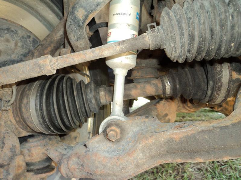

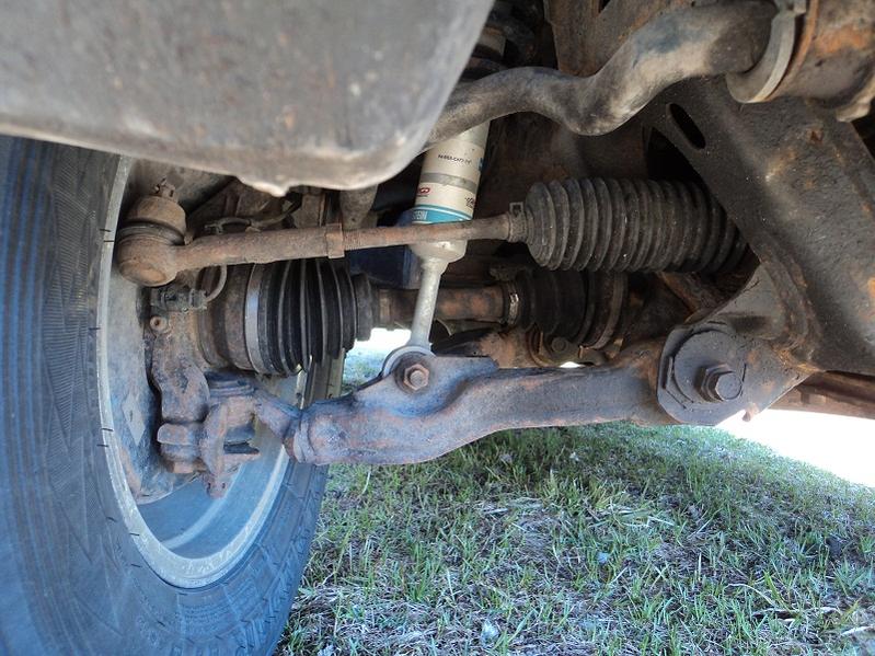

Here are some pics of the ride. 2007 4R Limited, but its a south american edition so there are a few differences.
Trd cal - those angles don't look too bad. Just keep an eye on them.
Toyota4 - zero cv issues at my current height.
