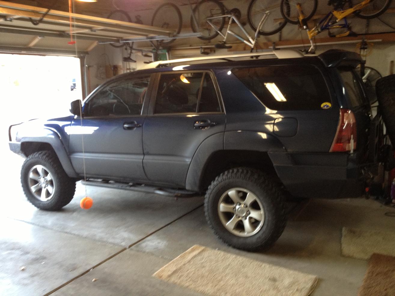

tire size for a 3" lift front and 3.5 rear with after market bumpers?
anyone got any ideas I would like to get the biggest I can ( first time hearing this huh lol )
thanks

With some trimming and wheel spacers, you could fit 285/70/17's. The aftermarket bumpers will help clear the 285's more easily. You could also do something like a 275/70/17 which is a little smaller but wouldn't require much trimming or wheel spacers.
