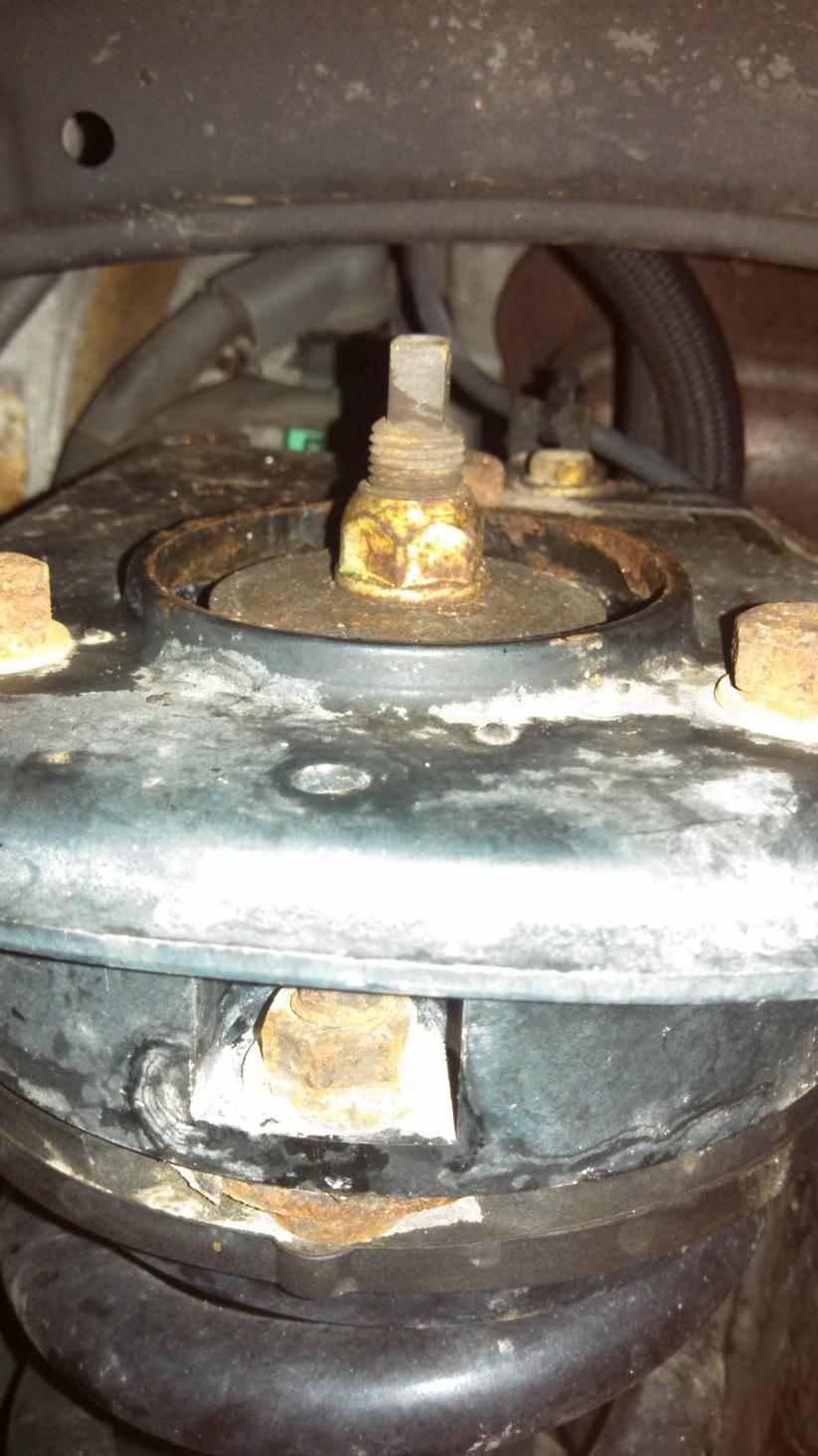

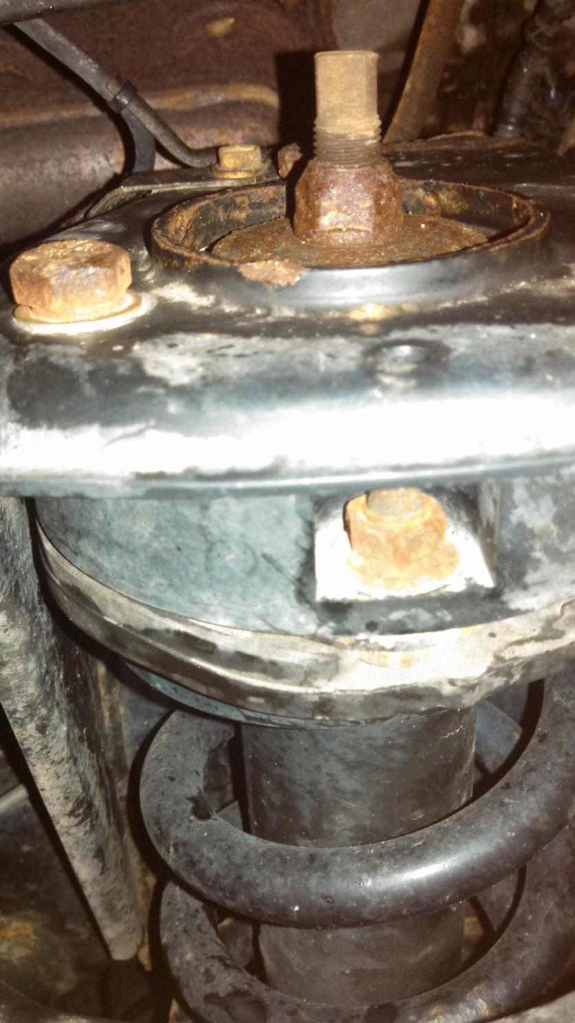

A while back, I had a shop replace my front xreas (LONG LONG STORY) and this is what the end result is right now

XREAS has started to leak, the shock is barely dampening and the springs are sagging so it's time for a front end overhaul.
Hey, ARK do you think I'll need new bushings or top hats? I can't really tell why the shocks aren't sitting the right way? The morons at the shop definitely butchered the install, but I need to know which parts to replace. I'm thinking they may have used the wrong bushings??
New bushings with your existing top hats will take care if that.....no sweat.
Should I replace the bushings at all you think? they almost look to me like they are the wrong size or that the shop really messed up and didnt install them correctly. Too bad it got to the point it did and the xreas got messed up. Good excuse to buy the billies while they were on sale.
Yes. In those pictures it looks like the upper bushings are wiped out. The top hat should be fine, unless it has been banged up from the shock moving around (unlikely).
When you order the 5100's just add new bushings & washers. Done and done.

Pic when you have a chance if you don't mind. I'm telling you, I think the upper bushings are the wrong part :redbrick:

driver/passenger sides attached

Looks different for my truck. [MENTION=98468]BigNuge[/MENTION] - maybe that lower nut is missing, part #9??
parts listed for the front strut assembly, top plate, shock, coil, lower bushing. aren't the bushings pressed into the top plate?
See the diagram I posted above for mine, looks like part #7 that isn't right.
