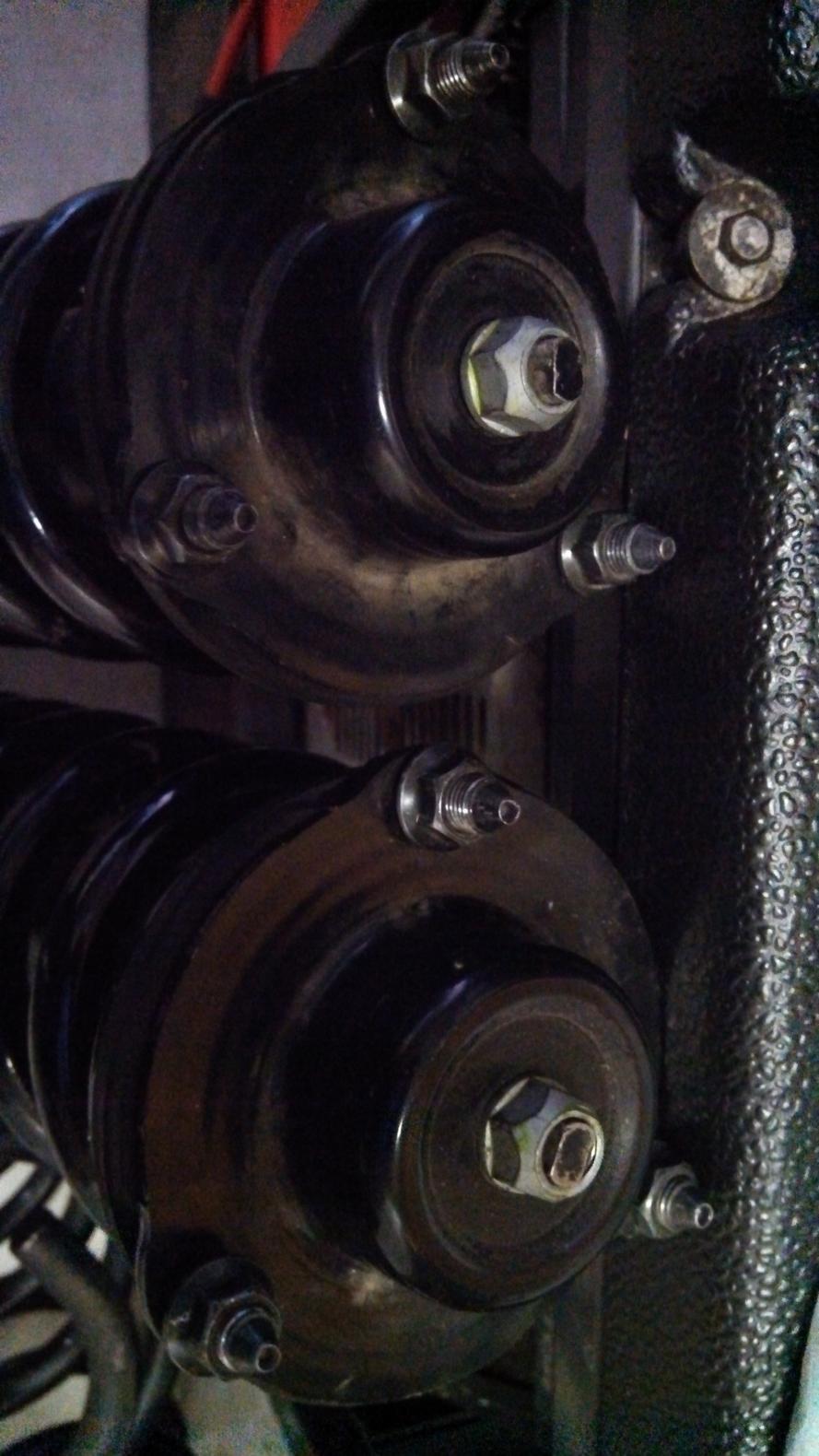

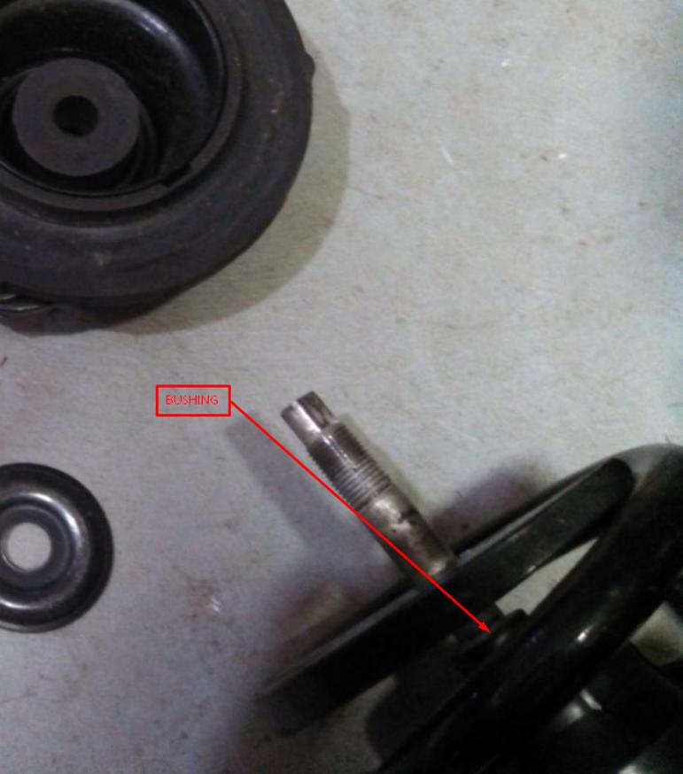

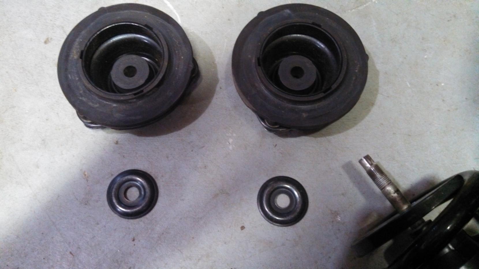

[MENTION=55855]zopperman[/MENTION] as promised, i investigated the fj struts i had, and found that things were weirder than i thought...so i have the bottom washer and bushing, but the top washer and bushing are mysteriously missing... pics attached.
Is it possible that the bottom bushings are still on the shocks and that the tops were placed over the bottoms and none on the top hats?
i get what youre saying, but theres nothing else there, its just the shaft of the shock to where it becomes threaded, and the bottom washer and bushing are there, the top bushing/washer combination are not there
What kind of shocks are the ones you have, and can you take a pick with out the coil?
