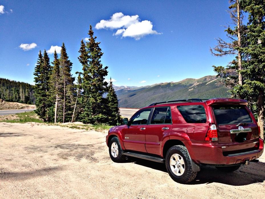

I've been doing quite a bite of reading and was able to decide on new tires as my first change to my new baby.
Went with 265/70/17 Duratrac tires and am now looking into new suspension as it seems as if my rear right shock is shot (light clatter over small bumps)
I think I've decided on the following setup but wanted to run it by the experts before pulling the trigger.
Billstien 5100's Front and Rear
FJ Coils Front And Rear
Daystar 2/1 Lift?
I use my truck more so as a daily driver and will take here to the mountains from time to time for outdoor activities. I'd like to make sure that the handling is compromised as least as possible while still having that aggressive look of a lift.
Any thoughts or pics would be truly appreciated.
PS- Can anyone from the Denver area recommend a good shop to have this work done at?
Thanks in advance.
