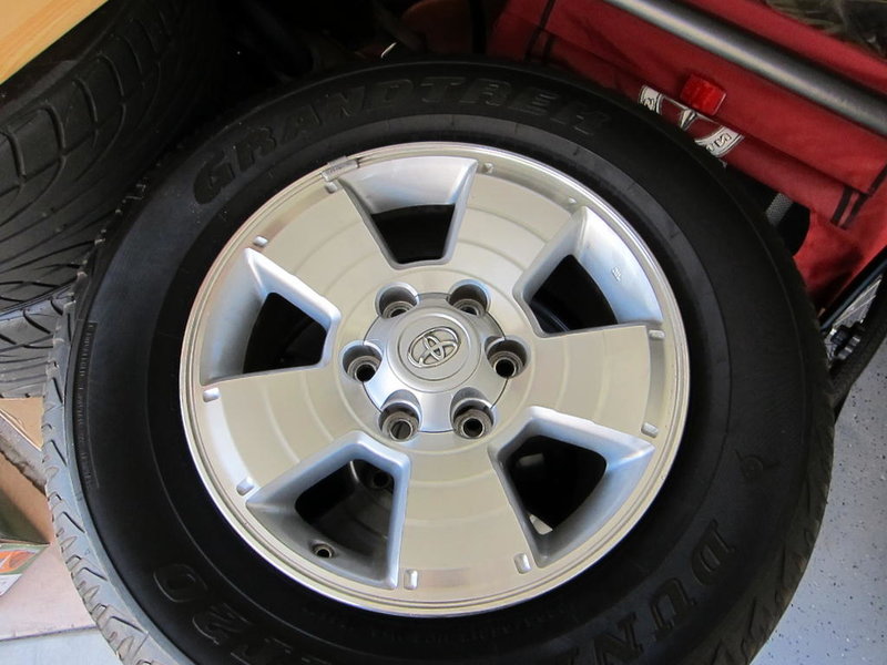

Future improvements will include larger tires. Plan to keep the 17" wheels that I have and maybe add 1.25" spidertrax as well. Also how goofy will this look if I have it for a few months before upgrading the tires :) ?
My wheels (not my photo)...
img_0441-jpg.102138
My tires are P265/65R17
