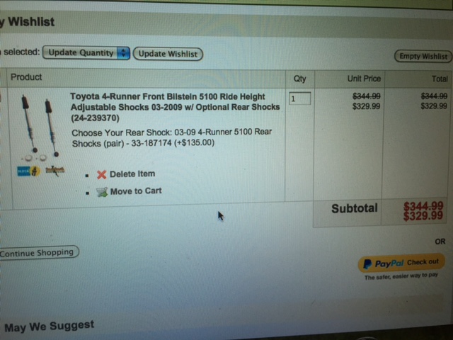

Man, looks like the price went waaay up??
any other places?
Again, This would be for a 2003 4runner -SR5 2 wheel drive

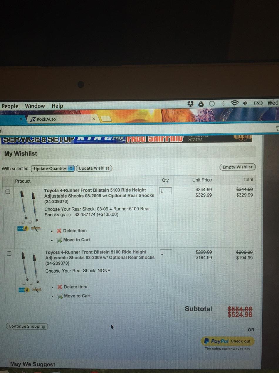

Looks like you have the front and rear selected on the first item, then rears again in the second.
Well that makes sense now. Didn't see that part. Good deal.
So with the mood coil springs and the shocks, will I need anything else? Sorry, just dont know squat about this and trusting yall suggestions.
Struts? Hell, i barley even know what they are. Are they installed with the shocks.

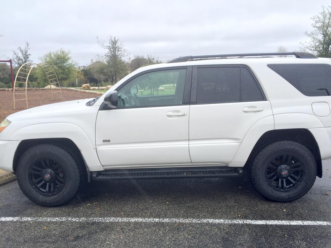

This is stock 03 with 265/70 R17's just installed. Was sisters car and never changed shocks or anything. So above is what I want to order. Anything else I need? Sorry again for all these questions, I don't know squat about this. Thanks guys.
The FJ springs and Bilstein shocks is all you need if you are replacing shocks and springs to get a little lift...and someone to install it.
Will it cause any issues with rubbing etc? If not, then spacers are mostly for aesthetics?
Lifting wont cause rubbing.
Increasing tire size can because they are physically bigger but the space they occupy stays the same.
Adding spacers can because it increases the radius of the steering arc, meaning the tire can move further forward and backward than without the spacer.
So yes, spacers are generally aesthetic add ons, but they can be used to help correct some rubbing from larger tires under certain combinations of modifications.
