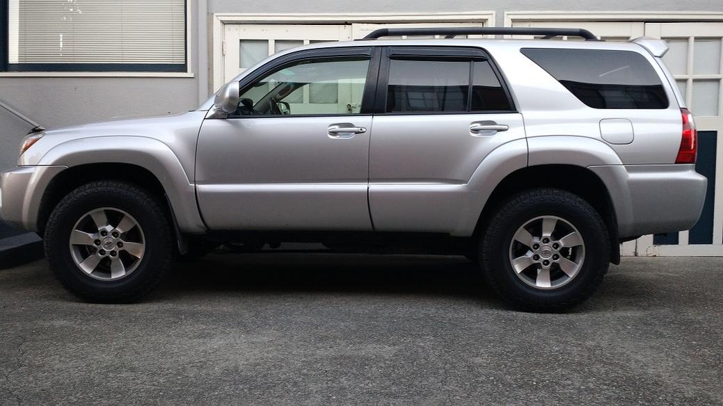

5100s all round, Tacoma TRD coils (new) up front and 5th gen rear coils in back. Lift seems to be around ~2"~up front and about 1" in back since i still have some rake. Tires are 255/75/17s on 5th gen sr5 wheels.
Could be done for a lot less using used Tacoma TRD strut/coils paired with bilstein 4600s in back or stock shocks with the 5th gen rear coils. Just another option..
