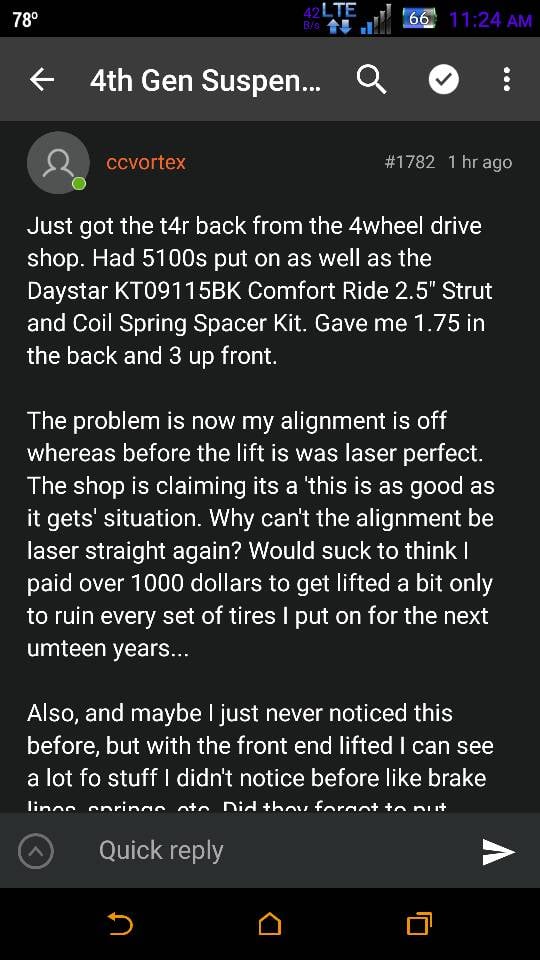

Apparently YOU need to reread your post.... Here's a screen shot to help. Second line, says, I have 5100's...

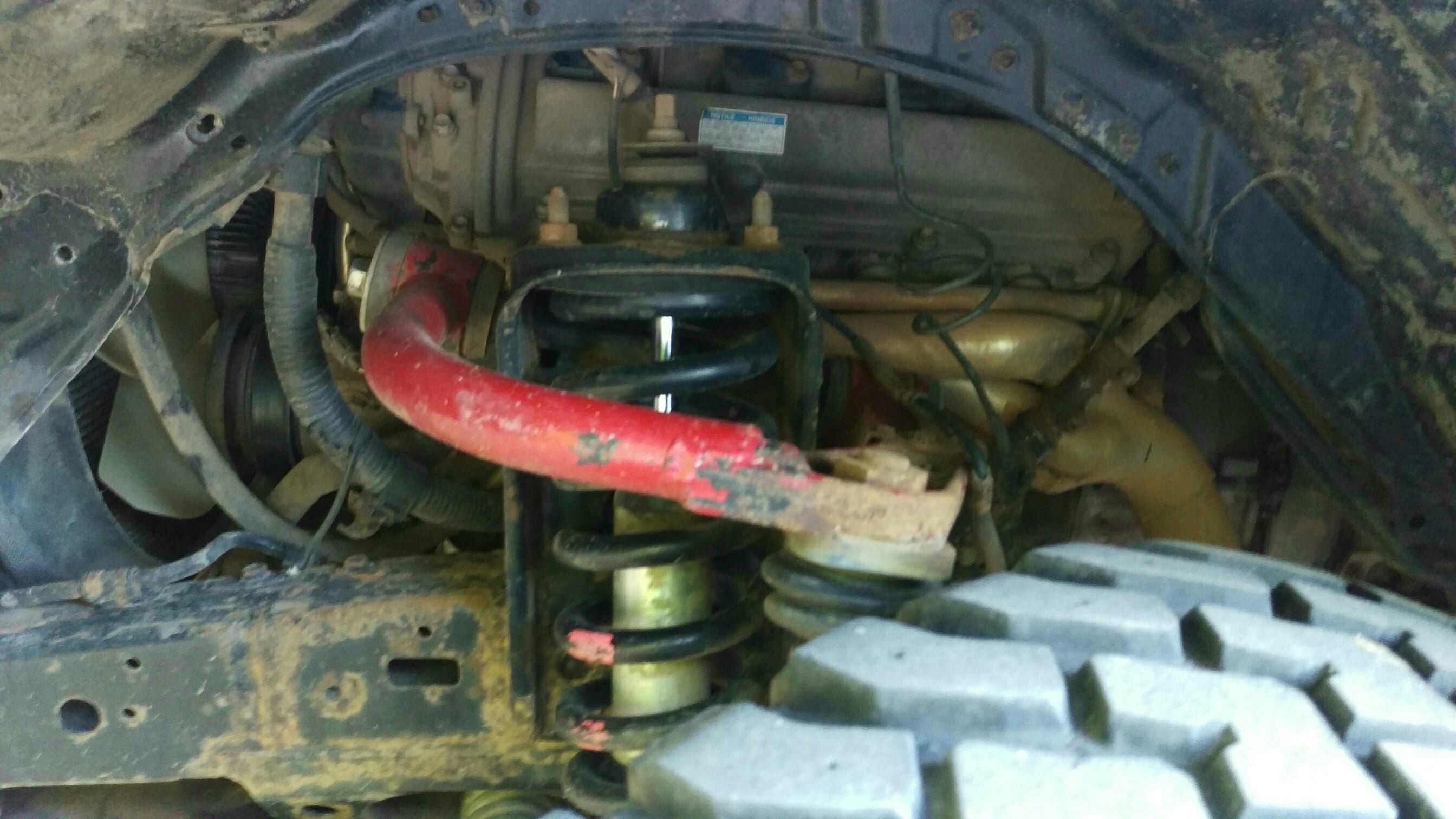

Pics:
http://i67.tinypic.com/2z3zwxx.jpg
http://i63.tinypic.com/2dgkvp2.jpg
Haha, wow, OK, then they must be adjustable from inside using invisible flanges or something because these shocks are a steel rod sticking out of a silver cylinder and nothing more.
Also, I just called the shop and they confirmed they used the spacers because the shocks were not adjustable.
