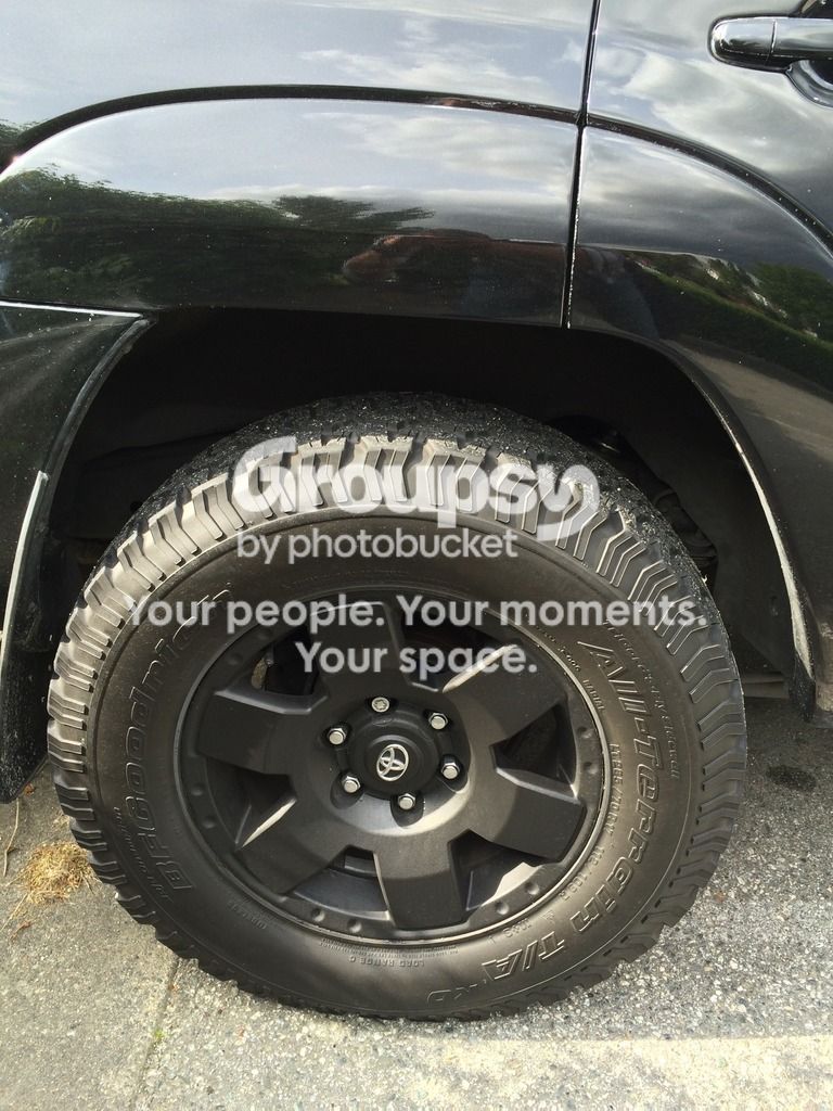

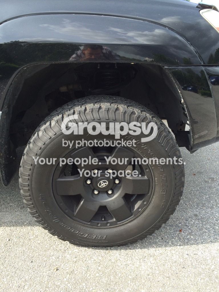

Oh wow never thought of that. Going downstairs now to check that because yes... The front are very high... I'll measure too but it was raised like 3-4 inches over the stock height. Had 150k miles on the stock springs so they could be sagging a bit.
Anyone else have that issue with the 5100's and FJ Moog's? Front being way higher.. 03 4Runner V8 Limited... It's on the 2nd of the 4 settings so should be at the .85.. expected it to be level but as seen, front is about 1-1.5 inches higher.. if not more.
