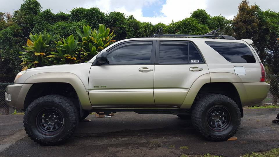

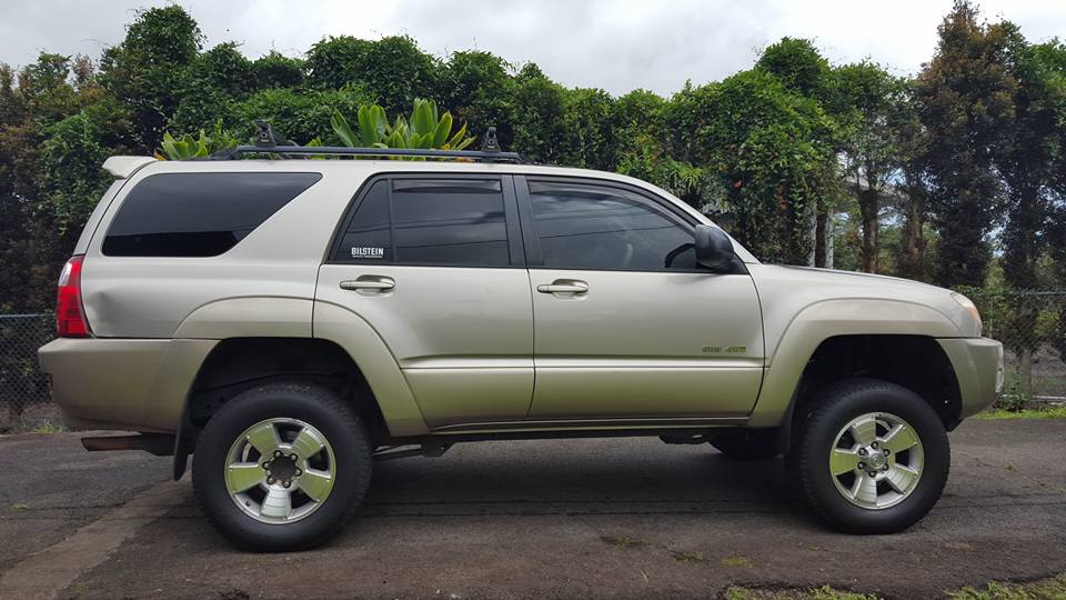

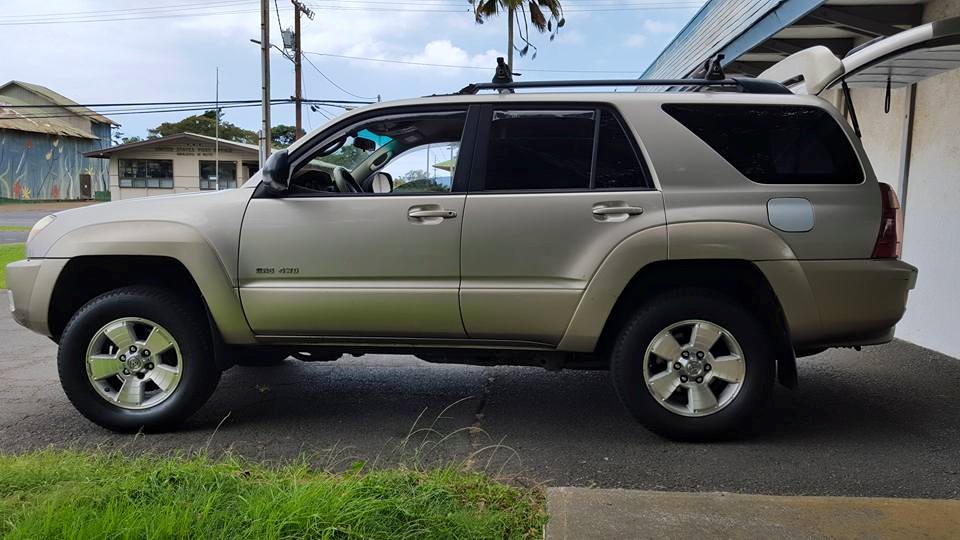

Great thread and very good information sharing on here gang thank you! I just finished my install of OME 885 coils and Bilstein 5100 struts up front set and second notch from the top. Also did my rear with Procomp FJ coils and Bilstein 5100 in the back. I really like how it turned out as the handling is great! Here are a couple pics of the metamorphosis of my 4th gen! there is first a before pic with only a front 3" spacer kit and then after the lift installation. Then finally with the Procomp rims and tires I installed as well. Again... many thanks to all of you who have great input that can help someone like me to install my own lift. Much mahalos from Hawaii!
Oh...one weird thing might be worthwhile exploring is that I had 35" from ground to fender in the front with the 3" motofab spacer and the stock struts and coils. Of course it was 32" before the spacer. Now with the spacer removed and the lift installed I have got 39" with the same sport rims and tires. I'm looking at a 7" difference. Out of the norm? I'm the 2nd owner of the vehicle and the coils and struts were replaced before I got the car. (cop car) The springs and struts were in decent shape and I've saved them in case I ever want to go back stock for whatever reasons. I am glad to have gotten a 7" lift with this set up when compared to the stock set I had on there to begin with. Alignment is scheduled and off roading will commence shortly!

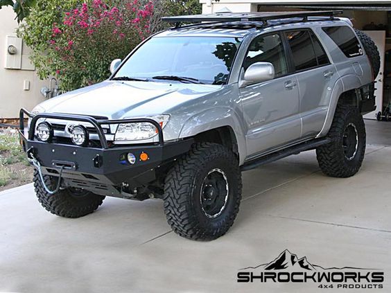

Need help on lift options
I have a 2006 sports edition V6 in Silver that I just bought 2 weeks ago.
It sits stock with 20" from center hub to fender on front and 21.5" center hub to fender on back.. Wheels are stock 17" with hankook MT 265/65/17
I want to lift it 3" front and back, and will be adding either a shrockworks or Demello bumper on front (or something similar), with possibility of CBI rear bumper with tire carrier in back. May also get some sliders.
I want to do some off road, but nothing hardcore like some of the crazy stuff some members do. Just some light trails and camping adventures.
But I really like the look of the trucks.
My Runner is a daily driver also.
Here is the hard part. What lift kit to get? There are just soo many options.:fear:
I would really appreciate some advice on the best kit for my situation based on your past experiences.
I want to be able to do it myself, and dont want to do it twice.
If i can get a top 3 choices including parts needed. And why you prefer your top setup.
Thanks alot, and look forward to getting your feedback.

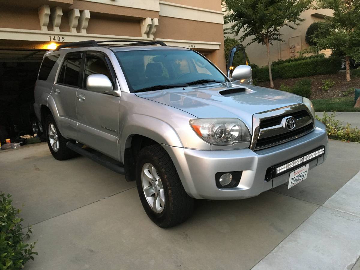

I have
What I have and what I Want..
I have a basically stock 06 Sport but I want to upgrade to the other pictured.
Thanks again for the feedback
