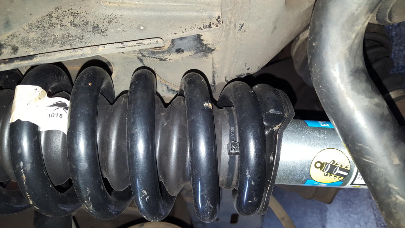

Are you sure the coil perches for the front 5100's are set properly and not upside down? Seems like you have a lot of lift and you are not set at max. See below:
WRONG WAY, UPSIDE DOWN:
Heres a pic of my old man emu 885 coil spring and bilstein 5100 up front. Sorry I'm really not good with a computer and photos this pic is sideways. But shows the correct placement of the lower plate on the bilsteins. I got some dust boots to install instead of the original bilstein boots. Happy wheelin everyone!

Great thread and very good information sharing on here gang thank you! I just finished my install of OME 885 coils and Bilstein 5100 struts up front set and second notch from the top. Also did my rear with Procomp FJ coils and Bilstein 5100 in the back. I really like how it turned out as the handling is great! Here are a couple pics of the metamorphosis of my 4th gen! there is first a before pic with only a front 3" spacer kit and then after the lift installation. Then finally with the Procomp rims and tires I installed as well. Again... many thanks to all of you who have great input that can help someone like me to install my own lift. Much mahalos from Hawaii!
Oh...one weird thing might be worthwhile exploring is that I had 35" from ground to fender in the front with the 3" motofab spacer and the stock struts and coils. Of course it was 32" before the spacer. Now with the spacer removed and the lift installed I have got 39" with the same sport rims and tires. I'm looking at a 7" difference. Out of the norm? I'm the 2nd owner of the vehicle and the coils and struts were replaced before I got the car. (cop car) The springs and struts were in decent shape and I've saved them in case I ever want to go back stock for whatever reasons. I am glad to have gotten a 7" lift with this set up when compared to the stock set I had on there to begin with. Alignment is scheduled and off roading will commence shortly!

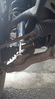

No way, +3? Wow. Your front must be at like 4.5 then. Is there any way you could get a pic of your cv axles? I'm curious to see the angles . Nevertheless the pic with black rims looks great. I'm going for that stance but with 885s with bilsteins on the lowest setting. Unless a diff drop will cure any harsh cv Angeles.
Heres some pics of the measurements with the stock shocks and springs with the motofab 1.5" spacer (3"net lift) where I had just over 35" from ground to fender. Then second pic is of the old man emu 885 and bilstein 5100 lift installed (no spacer) showing just over 39" from ground to fender. which is very weird as the original stock height before spacer was 33" so im looking at a gain of roughly 6" in front WHICH IS OBSCENE. The next pics show the cv angles both passenger and drivers side after lift installation. I apologize for the crappy pictures as I'm trying to learn to edit my pics with cropping and resizing. ALOHA FROM HAWAII GANG!

That's because you have the perch on the shocks up on the top setting. So that's 2.5" plus what the springs give you. Be careful, you'll destroy your shocks in short order.

Aloha tman! I had them on the top setting and then redid it to the next lower level. The ride was way too stiff for my liking and felt real rigid and the struts were screaming to me HELP! So these pics are at the lower setting. I never would have thought of that the way you mentioned. So its the 885 lift springs (near3") plus the setting on the bilsteins? So if installed the lift at the zero notch on the bilsteins it would still be a near 3" lift just because of the springs? Good to know this stuff thank you for clearing that up for me. Now it makes sense. This forum rocks!!

Yes, the lift springs will do the lifting all on there own. Also you can break your shocks by putting to much load on them by adjusting the collar up on the shocks. Not to mention bushings. Lol looks good though man!
