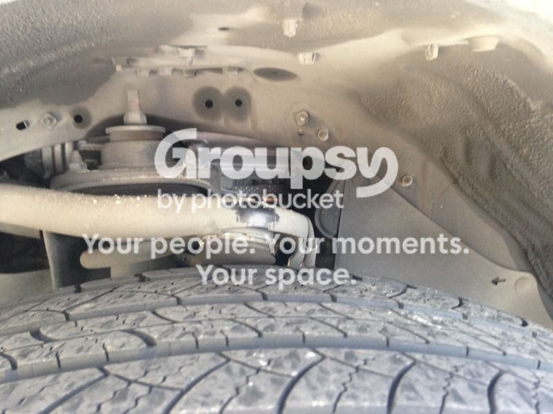

Just got a new to me v8 4wd limited and I took it out on the beach, looks like the tire rubbed the control arm a little while we were out. Completely stock with some road going Michelin tires. <65k miles and also has a faint steering wheel shimmy around 75mph.
Any ideas why?
