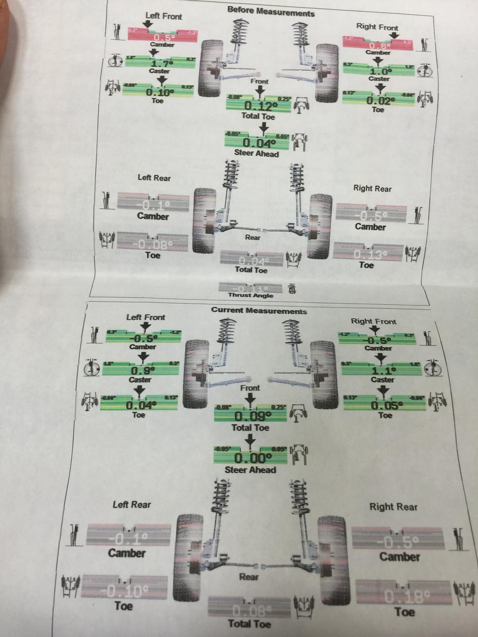

Here is what was done alignment wise after the lift. What changes do I need to make?

From the looks of your sheet your other numbers look good so I don't think there is much room for them to try and gain Caster without throwing off your Camber. Do you only have a spacer in the front or did you change coils as well. There are a few us us, myself included running uniball UCAs purchased from eBay with good success.

Re-looking at your sheet, I would suggest taking it to a different shop to get an alignment. Try to find one in your area with good reviews, not a "toe and go" type place. The reason I say taking it to a different shop is because I do not trust why they show your Caster in the Green and your spec range to only be between 0.3 and 1.8. The standard ranger for Caster on a 2wd 4Runner should be between 2.6 and 4.1 and 4wd varies slightly from those numbers but not much. The Camber and Toe number ranges on your sheet are within Factory spec, but again they changed the Caster spec numbers to show you green without telling you they were not within spec.

Numbers backwards? Most do a larger lift in the front. A larger lift in the back will decrease caster.
I'm running 2.5" front, 1.5" rear and still have stock arms. My caster is ~1.8° on both sides. It doesn't feel loose/darty at highway speeds, but increasing the caster on mine would likely improve steering slightly. I feel like I could increase my caster with stock arms if I could find a good alignment tech. [Somebody know a good shop in the Seattle area that knows how to align a lifted ride?]
If you did mistype your lift numbers, you can get a better alignment with your stock arms. Prob. not 3-4° but still enough to stabilize it at freeway speeds.
