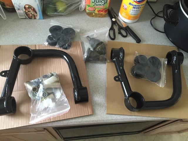

The fitment was very good IMO. I had no issues, the sleeves and poly bushings fit well.
I'm not sure exactly how much added caster they give you. You could email the seller and possibly find out.
It's crazy how similar they are to the camberg UCAs.
The link in my signature is my build thread with more info.
