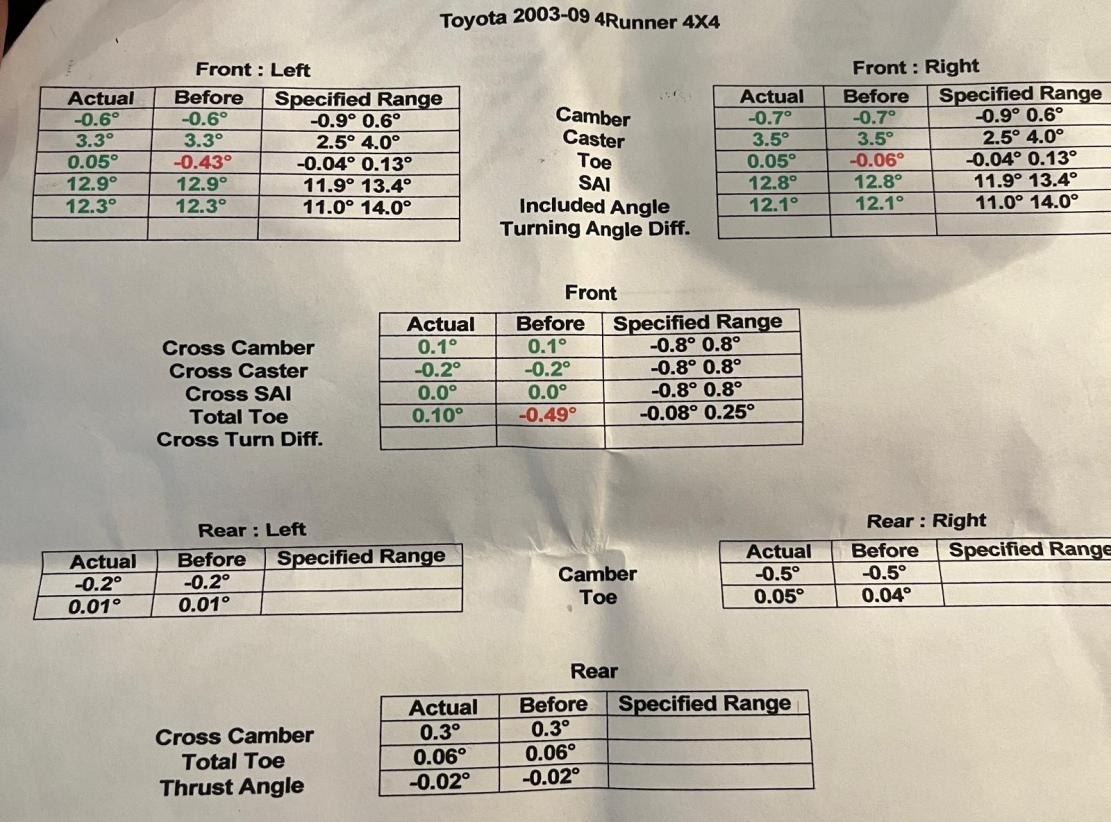

Did the Xreas delete and put some 5th Gen TRD Shocks/Coils on my 2007 V8. The new setup feels squishy/floaty. Changed the sway bar bushings, put new tires (Yokohama 265/65/R17) and got an alignment to try to tighten up but still feeling uneasy on highways.
Any advice on where to turn now to help regain some of the control of the OEM design?
Thanks!
Here is a picture of the alignment. Car is at 175,000 miles.
