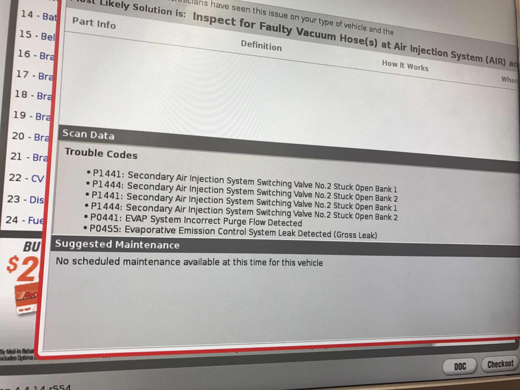

Well, went to AutoZone and had the truck scanned. I was expecting the AIP took a crap on me. Ordering the Hewitt-Tech bypass kit tomorrow
Sounds like AIP system failure induced limp mode, most likely valves stuck closed. Install the bypass and be done with it. I preemptively installed it on mine because we spent $1500 having it fixed on a GX prior to knowing how easy the bypass was.
