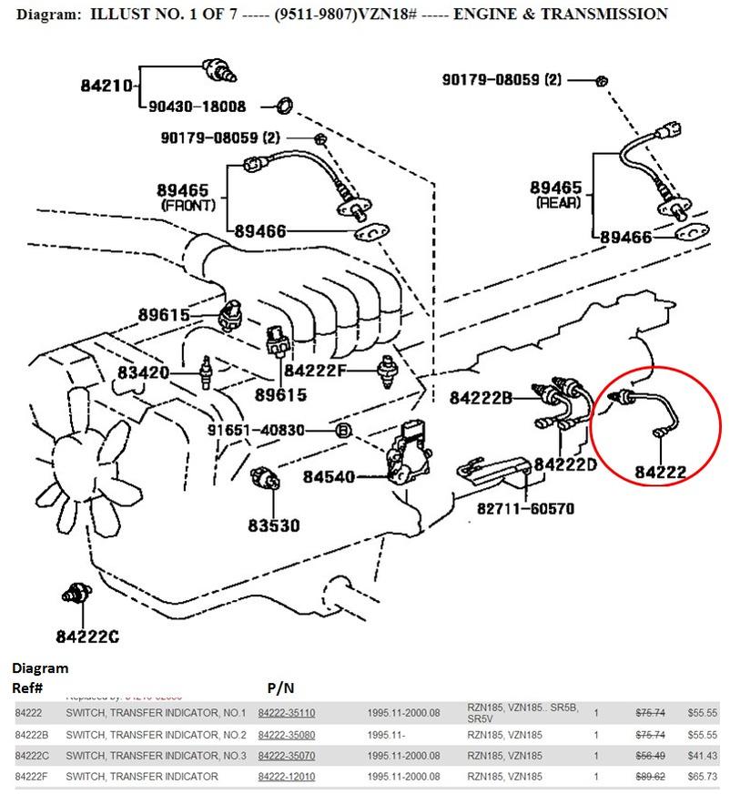

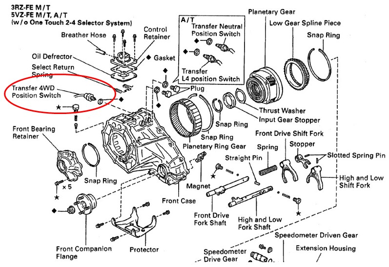

My 97 T4R 5-speed wouldn't engage the front axle when in 4H or 4L. Based on some past threads, I traced it to the 4WD transfer indicator switch since it works when I short the plug on the ECU side. This is the sensor on the passenger side transfer case that opens or shorts based on the transfer case stick position. Problem is, I can't figure out how to replace it - there is no room! Has anyone replaced it before? If so, how did you do it? Do I use an O2 sensor socket from the bottom?
Also, does anyone know the p/n of the switch? There are 2 switches on the transfer case. The diagram at ToyoMotorParts shows both on the passenger side while the FSM (correctly) shows one on each side.
Just wanted to follow up and provide insight to someone who might have this same problem in the future. The correct part number for the Transfer 4WD Position Switch is 84222-35110.
I could not figure out how to get the switch out without lowering the transmission and I didn't want to tackle this, so off to the mechanic it went and that's what he had to do. As for the part number, he and the parts house was as confused as I was given that Toyota's parts diagram showed the switch to be on the passenger (wrong) side and the parts descriptions did not match. He ended up ordering both 84222 and 84222B (Transfer L4 position switch) just to be sure. What's funny is that they look absolutely identical, down to the connector, case, thread length and pitch, etc., the only difference being a slight difference in how the wires look coming out of the sensor case. I believe it was 27mm but think you would need an open-ended or crowfoot wrench.

Checking the 3 switches (4HI, 4LO, N) shows no continuity on any in any shifter position. I assume the switches are bad, but do feel it's odd that all 3 are out.. (Just to note it, jumping the 4HI switch plug activates the 4wd. Rest of system working.)
My question is: is there an armature or such inside the upper t-case which engages the switches? A different way: is it possible that something is missing/bent/broken and causing the switches not to get pushed?

The j shift type is much simpler than what most of the posters there seem to be dealing with. From what I understand (for 2000), it's just mechanical shift on the t-case, which then activates one of 3 (t-case) switches to tell ecm/tcm to go to 4wd, and those switches tell ecm/tcm to activate VSV, which then sends vacuum to the front diff actuator, and, when actuator actuates, front diff switch sends confirmation and lights the dash light.
Since I can jump the t-case switch and lock it in, I assume ecm/tcm, vsv, f diff actuator and switch are all fine.
The boggle is just what internal to the t-case pushes the switches in. Since they're about 3 inches rear of the shift lever, I assume there is a slide or armature that gets pushed by the shift lever to switch the switches.
No diagrams show such, but that definitely doesn't mean that it isn't there.. More likely, just not what they intended to show on the diagram.
