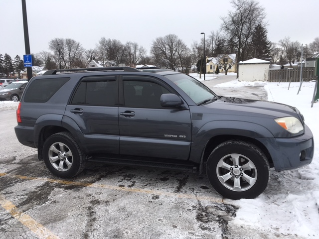

Hello. 2008 V8 here with 100k miles. I just installed the 5100's with the stock springs. With the fronts set to 1.75" the front end was just barely higher than the rear. For camping and cargo purposes I chose to install a rear 1.5" spacer for a boost.
Here is the truck before the rear 1.5" spacer. (Front set to 1.75")

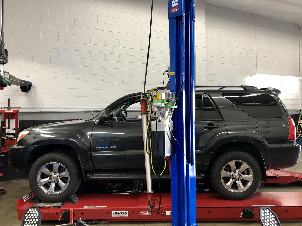

I put 5100's on my 2006 Limited v6 with stock V8 coils I purchased used from a forum member here. They had about 100k on them at time of purchase.
5100's were set at .85.
It gave me a nice lift in front. Not too crazy but enough for me.
