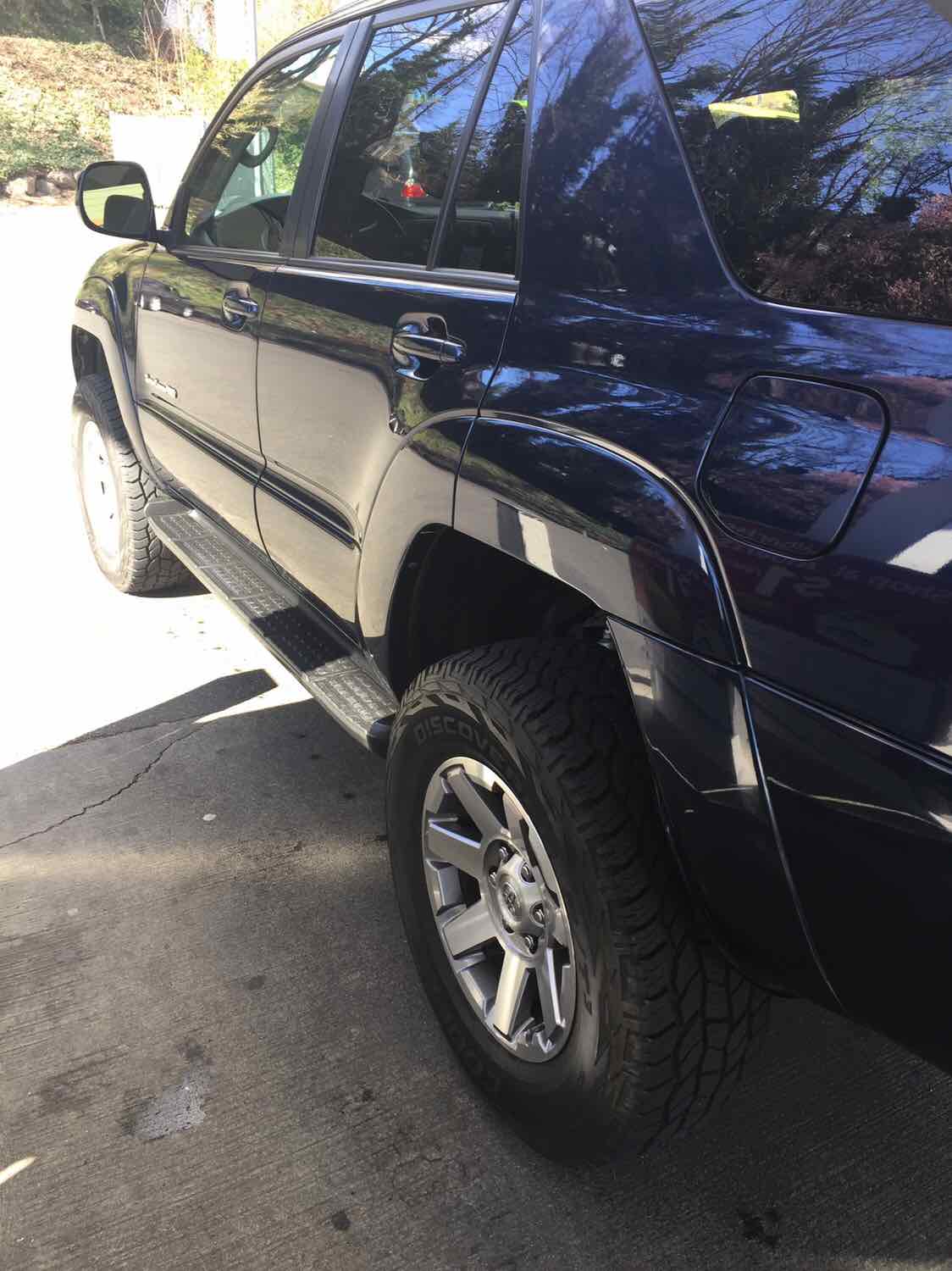

just lifted my 4runner (stock springs)
billies on all 4 corners. front set to 1.75. 1 in rear spacers from burtmans.

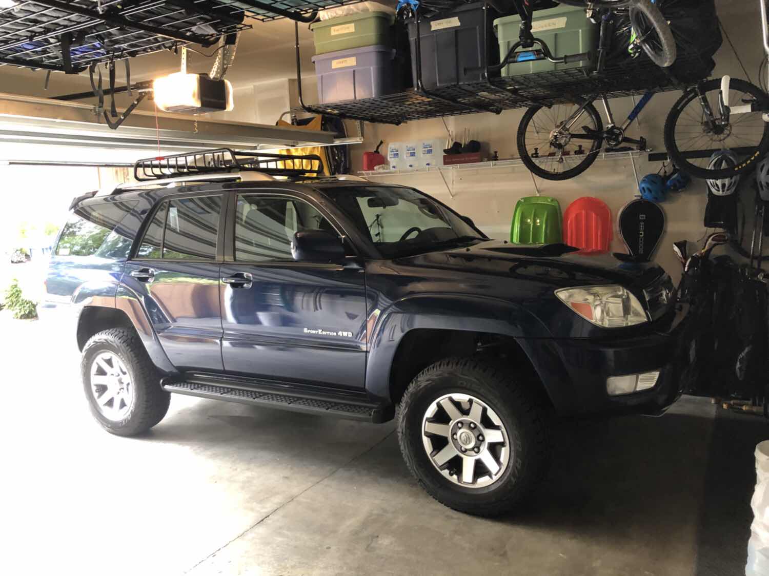

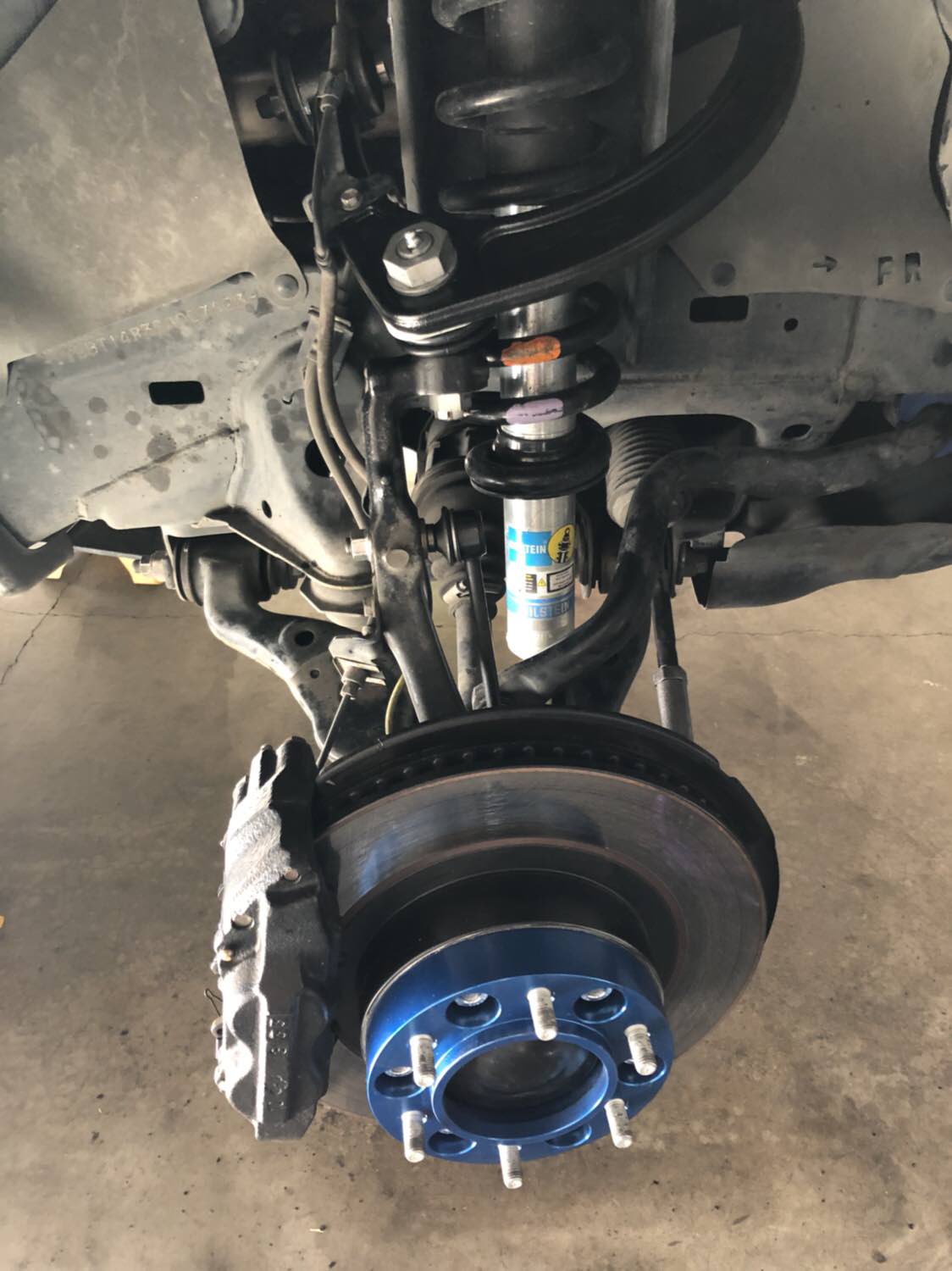

I have the exact same setup. FJ 4x4 coils front and rear, 5100s all 4 corners, front set at 1.75 and Daystar 1.5” rear.
Installed SPC UCAs to get a bit more caster. He is very smooth, but stiffer than stock. I also have poly sway bar bushings and relocation kit. No diff drop.

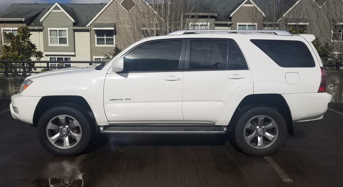

Sorry pal, long last couple of days. Here you go-
One callout is that I also installed Airlift 1000 bag stystem and at the recommended min 5 PSI, the rear is pretty stiff. Without them inflated to that 5 PSI, this thing was like driving a dream.
