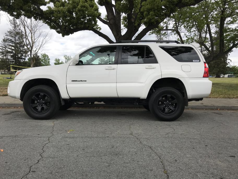

I am running 5100s all the way around with FJ Springs (new takeoffs off Craigslist). My front billies are set at 1.75” and I had a 1.5” Daystar spacer in the rear.
Looks awesome! Thanks for the pics and info. I’ll be sure to jump on that down the road!
Looks good! What are your Bilsteins set at? I’m thinking lowest setting, with both front/rear FJ spring, and daystar 2.5/1.5
It’s at the 1.75 setting and I only used the spacer in the back because the springs give you about an inch lift themselves in the front. Adding too much lift might not be good for the truck and you will have to install different UCA’s for the added height
