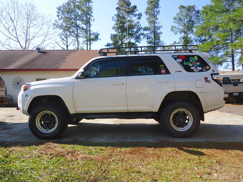

I'm not running the 884's, but I do have 885's in a similar setup. I have my 5100's set at 0 because I only wanted 2" of lift. And with my front bumper and winch I needed a little stiffer spring. I am looking at exactly 2" of lift up front. If you set your 5100's at 0.85" you will end up at or near 2.85" total lift up front. Here is mine unloaded before I added the rear bumper. The rear end is what Toytec +10% springs will look like with no rear load.
