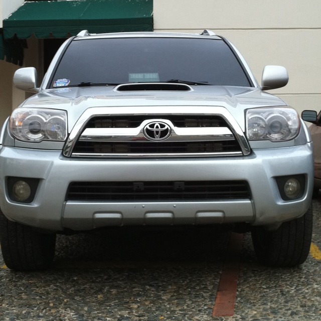

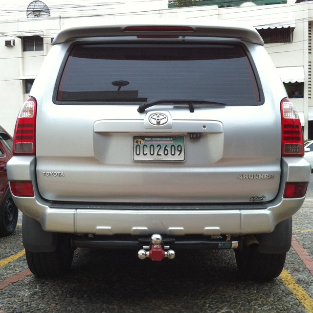

Here are some pictures, and no, I didn´t get the spare.
I mentioned this in your other picture thread...but man I gotta ask again....what's the deal with the mish-mash of parts? Your front end is all '06+ complete with rounded wheel wells, the back end is all '03-'05 with squared off wheel wells. And of course you have '06+ LED tails. And to top it all off, you have 2010 wheels! You have quite the mutt there! LOL
with 22s, u only loose about 1-2 inch of rubber, not much difference from the 20's. im using 285/40r22. its fine. the 06 front in looks funny, gota have the back wider to match it. maybe take off all the flares off and use the wide ones from shuei i think, jason burtman sells them.
few members here have 22's i think some of them have a bigger tire size than me, 285/40r22 fits fine on my stock sport edition suspension, fo sheezy using 285/45r22, but i think u need a small lift, and matt-x is using 305/45 r22, but he lifted his truck too. baby runner using 285/40 r24. check the pimp zone section, and u see some different tire sizes, 285/40r22 matches the 265/65 r17 very close. i think tirerack and other tire dealer uses 275/42r22, i think that is close to a 265/70/r17. its possible to put 26's. but think 24's should be max on a 4runner.
So do you have any plans to make the front & rear wheel well openings match? Or does it not bother you that the front is round and the back in square?
