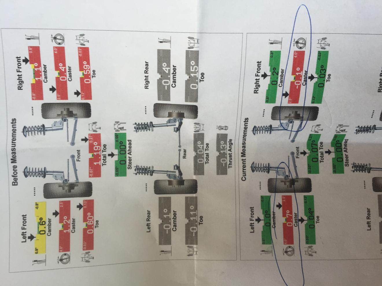

I just installed this kit from toytec bilstein on my 16' sr5 and dropped it off for an alignment this morning. I have to say It's driving as nice as before if not better. The install took me two nights after work to install, one night for the front, the other for the rear. Anyway, I received the computer print out from the alignment shop after I picked it up and wanted to ask your opinions of the results.

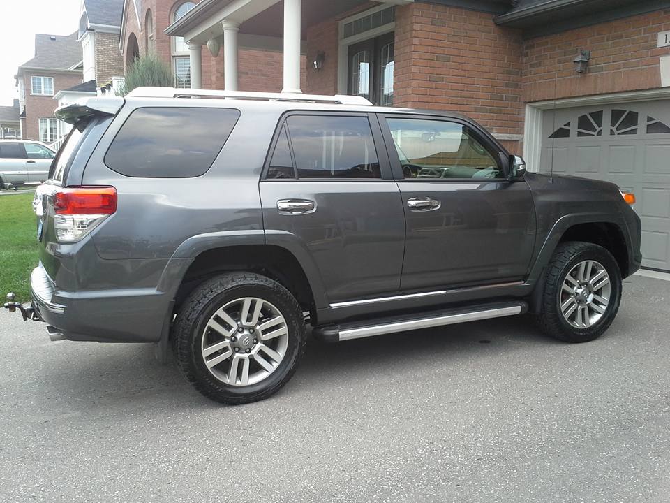

I have a 2013 Limited with XREAS and I used the Daystar KT09133BK leveling kit in the front and the KT09127BK in the rear. I had bought the Toytec 2.5" lift kit but decided I didn't want to mess with bleeding the front struts. The Toytec kit uses the same Daystar rear spacers. I should probably throw it up for sale, it's still on shelf in my shop.
Tires in this picture are Bridgestone Revo2 275/55R20.
