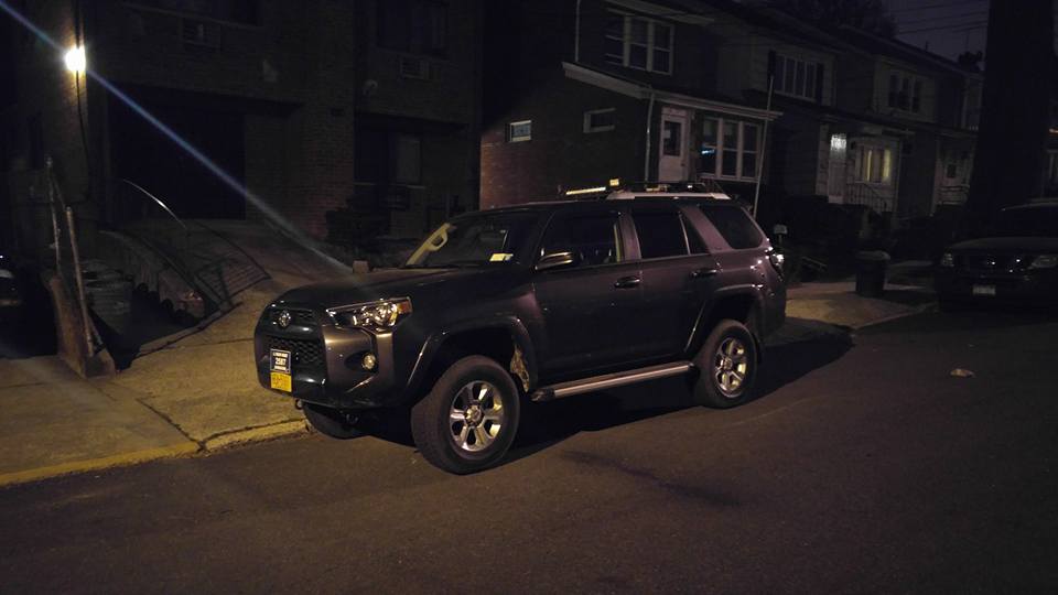

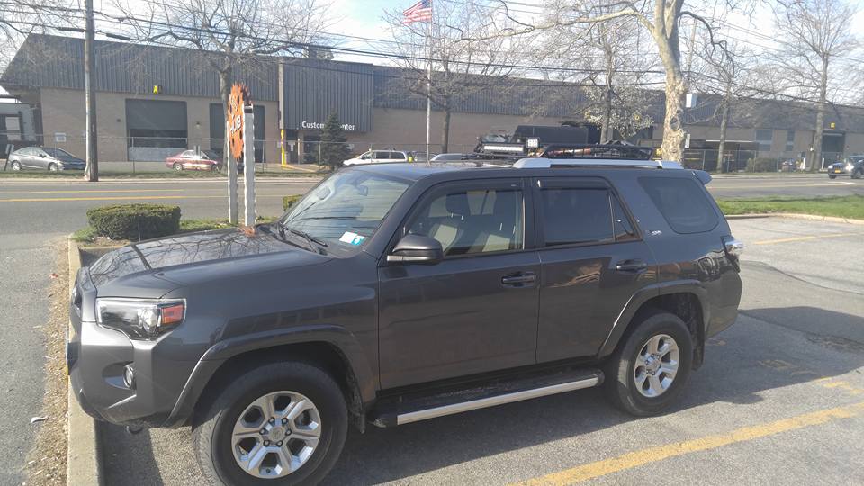

This is the before and after for the Rough Country 765.20 spacer kit with n2.0 rear shocks.

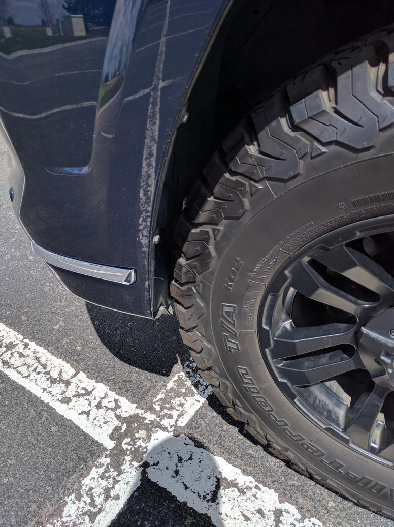

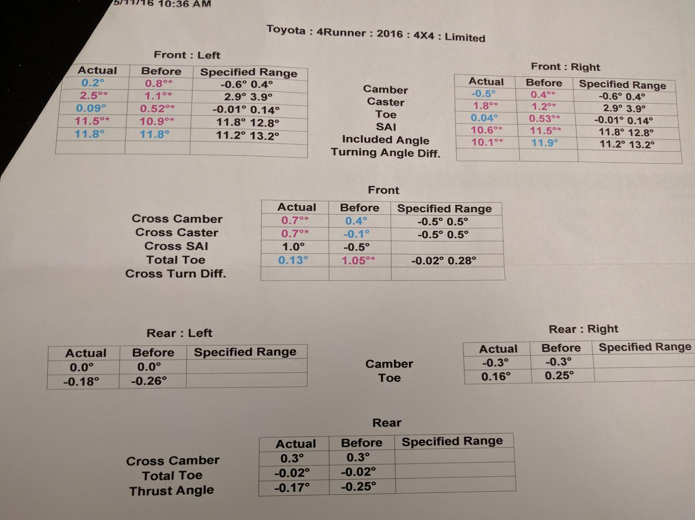

Hey guys, I am hoping I can get some insight on an issue I am having after I installed new tires/wheels and Daystar spacers in my '16 LE. Soon after I bought my 4runner I put on BFG KO2's (275/70/17) onto -6 offset wheels. I had rubbing pretty bad so I did the fender liner mod but still rubbed near and at full lock at the back of the wheel wells. So, last Friday night I installed Daystar spacers (2.5/1.5) and had no rubbing at all. I tried to get an alignment at Big O Tires on Saturday but apparently their machine was not updated for 2016. After waiting a few days for them to get their machine updated I just had the alignment done. Driving back to my office I noticed it seemed to pull a little to the right over 45 MPH and my steering wheel is a little off center (to the right). I called Big O and was told that it is because all of the roads around here are cupped and that it is normal. Pulling into my parking lot I also am rubbing again on the front right. I am hoping that someone with a bit more knowledge than me might be able to give some input. Alignment specs are attached along with a pic of the tire hitting the fender. Thank you in advance!

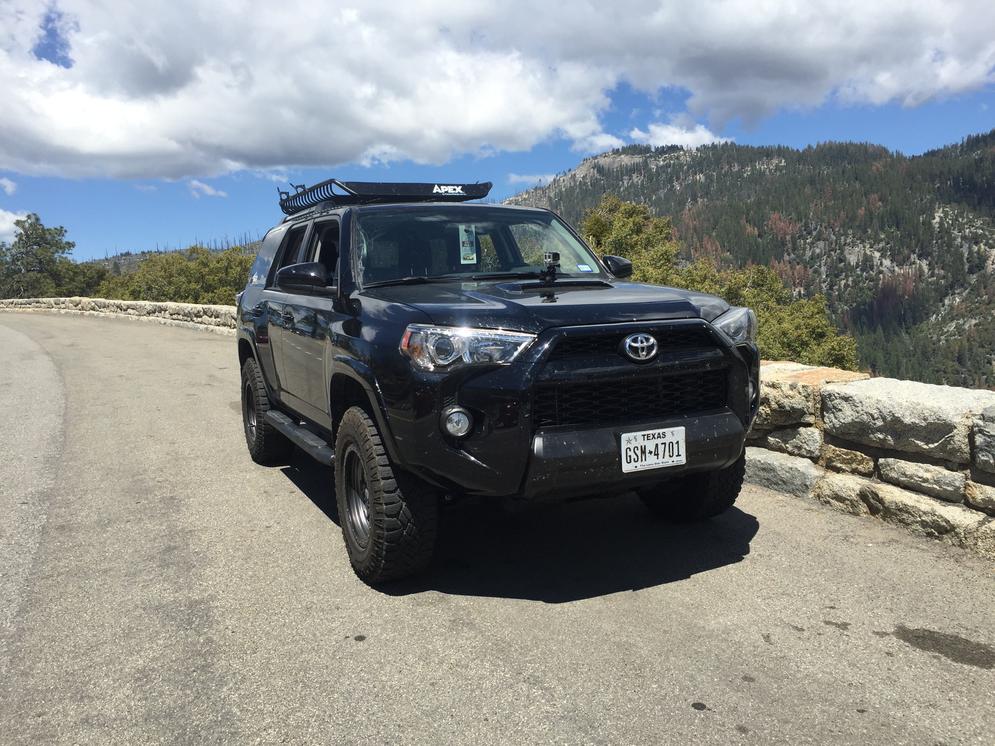

Looking to do a 2-3in all around suspension. Unsure if I need UCA's, not a huge off-road guy but I like to when I can. Not wanting to spend a ton, ICON stage 1 looks good but think I could find better for that price. Have a 1in revtek leveling now, running 265/70/17 with some rubbing. Any advice? hoping with install no more than 3k. May install myself just have to go back to the swamps for a weekend trip.
