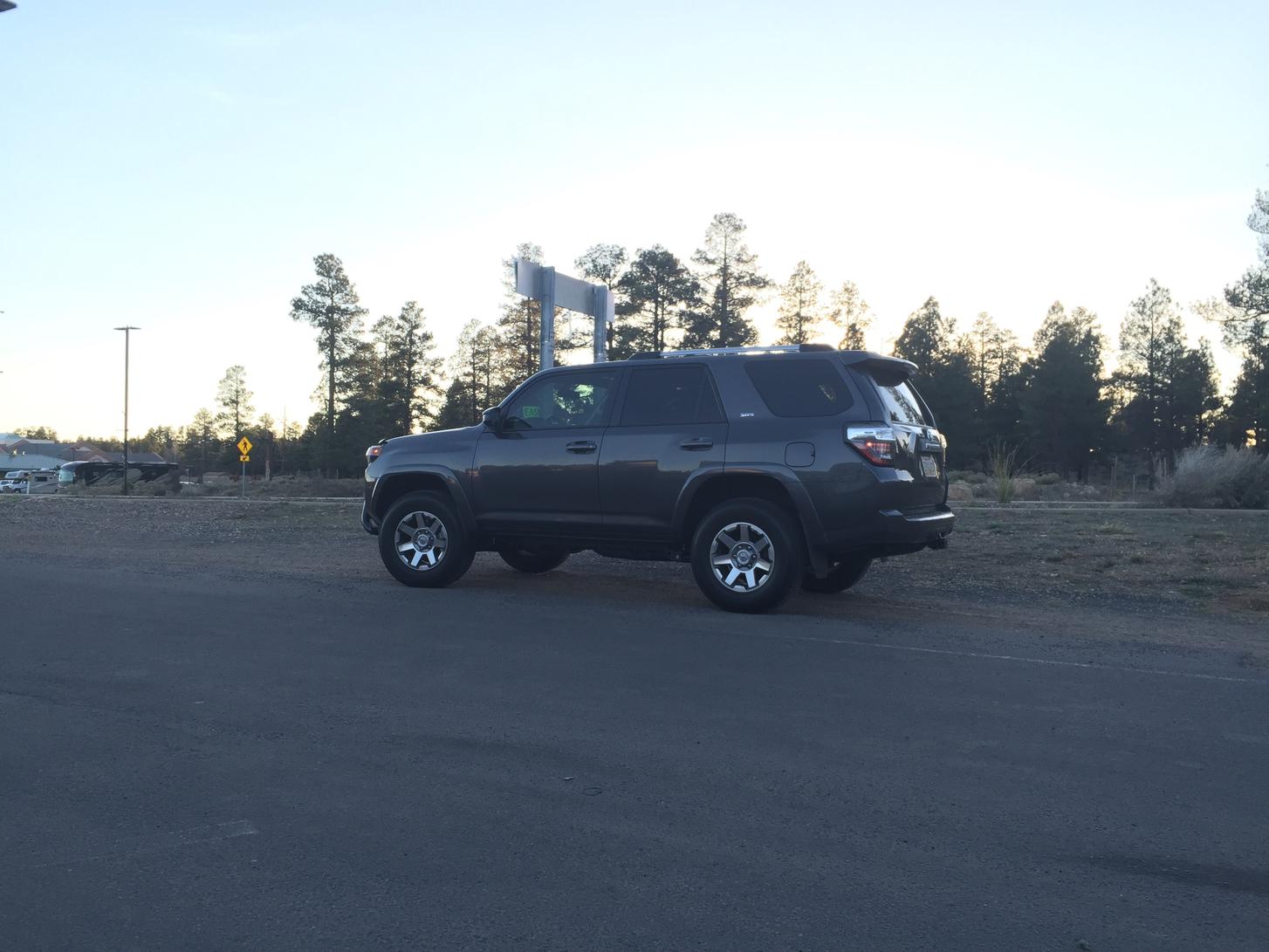

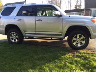

Front - struts preassemebled by Wheeler’s Offroad (Bilstien 5100 shocks set at 0, 2 1/2” Toytech lift spring, new bushings) & 1/4” spacer on front driver-side, Total Chaos uniball upper control arms.
Rear - (Bilstien 5100 shocks & OME HD 2” lift springs).
Differential drop.
I am very happy about the ride / handling improvement. It’s still comfortable and not at all bouncy or harsh. The body roll and break dive is greatly reduced. I also like the slight ground clearance improvement. As far as looks, I think it’s only slightly noticable to the untrained eye unless they're really paying attention. It does make the tires look a little smaller. Toytech & Wheeler’s were very helpful.
Thanks for your help everyone!
JD

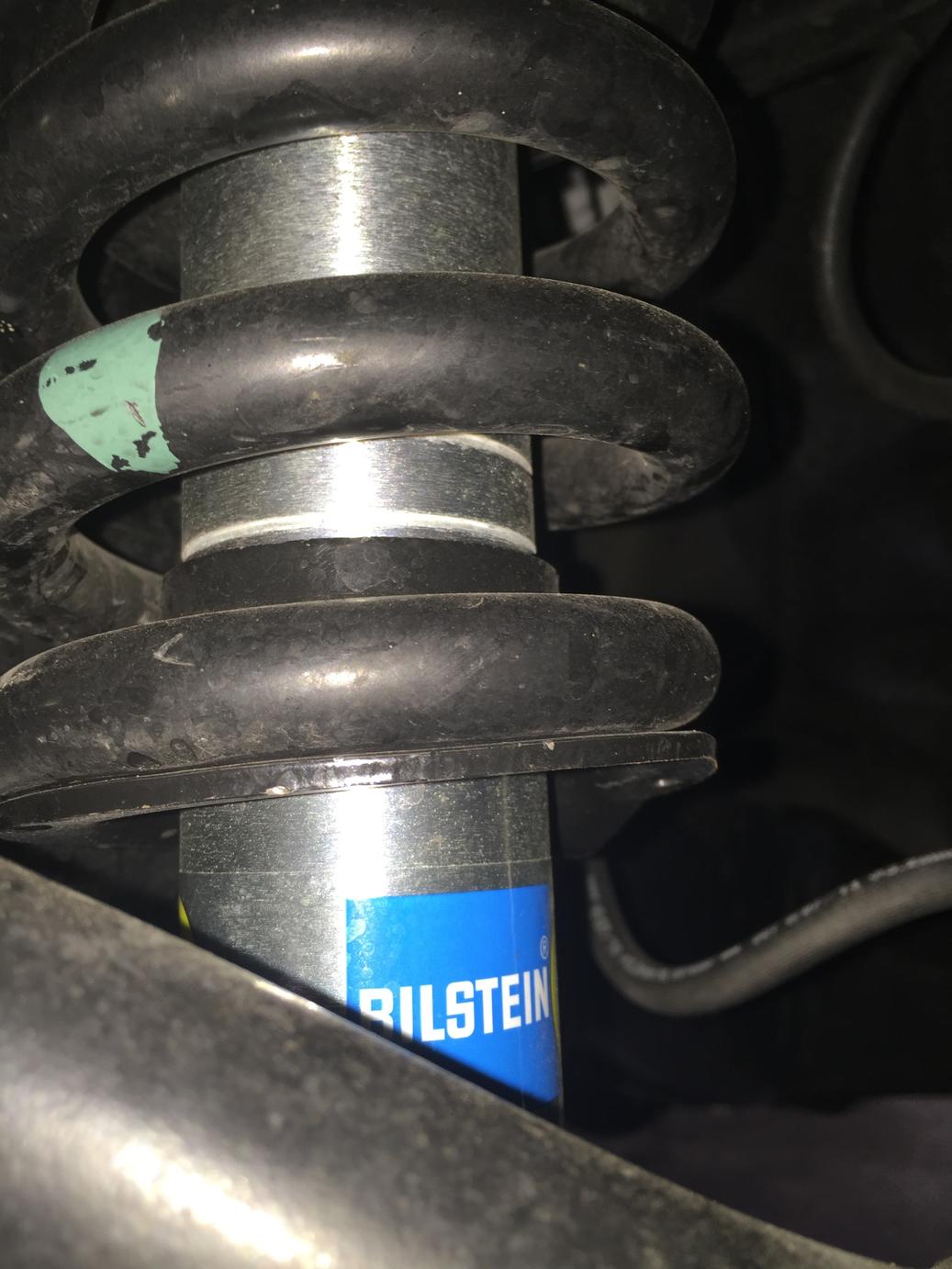

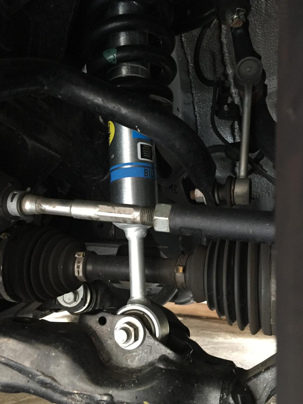

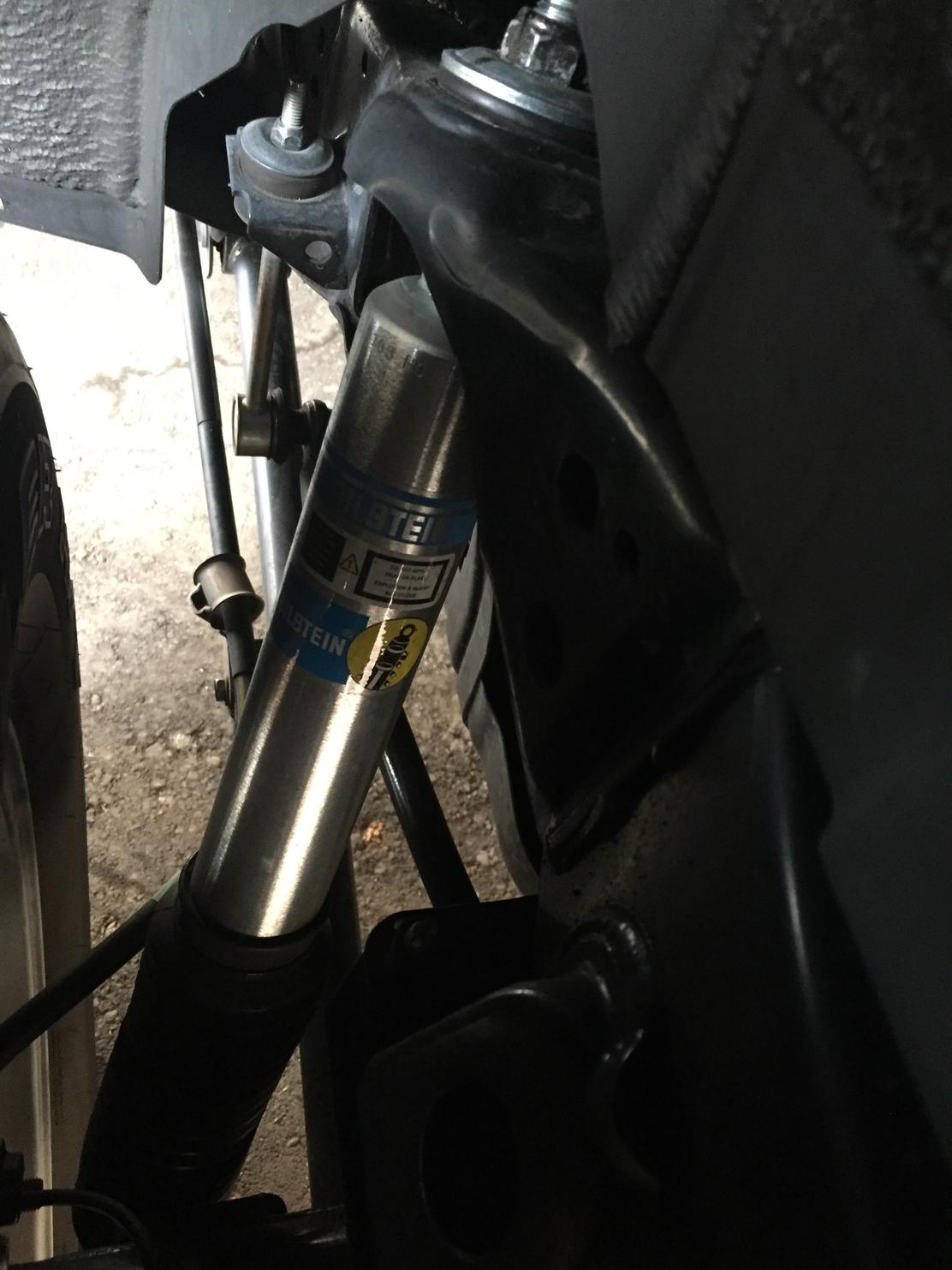

Safe to say that I'm an amateur when it comes to lifts, although this write-up has helped a lot. Im at a sort of standstill regarding how to progress further in my build. I have a 2014 SR5 that was purchased two months ago, since that time I have stumbled upon this website through my interests in lifting my runner and adding some larger tires.
A little background...
At the time of purchase I did not know that there were aftermarket shocks (bilstein 5100s, if I'm not mistaken). Once I got down to examining the T4R further, I noticed that the shocks were, in fact, not stock. I have a few questions to ask the pro's out here.
- Are the front shocks the adjustable 5100s? If so, what setting are they at?
- The rear only has the 5100s. Am I correct in understanding that I will need aftermarket coils or spacers to achieve a lift? Which option is superior? If coils are superior, do you guys have any suggestions? (I'd like to get close to 2-3" if possible, leveled)
Please feel free to correct me on any detail I may have stated incorrectly, I'm here humbly asking for help!
Thanks

The notches in your front shocks say they are the adjustable kind. I can't be positive but they look like they may be set at the 2nd notch (0.85"). As far as recommendations for the rear, I would ask do you plan to off road it much, or stay on the civil path? If planning to off road regularly I would recommend springs over spacers, but that would just be my choice. Some folks off road fine with spacers back there.

Those are for sure bilstein 5100s set on the first or second notch. To lift the rear you can go with a 1.5" daystar spacer or icon makes some really nice 2" rear coils that a lot of members here go with. Spacer is about 40, coils are around 220.

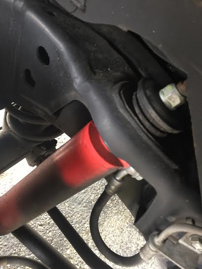

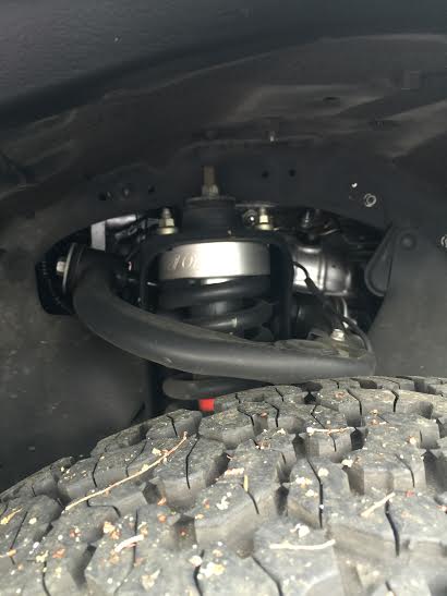

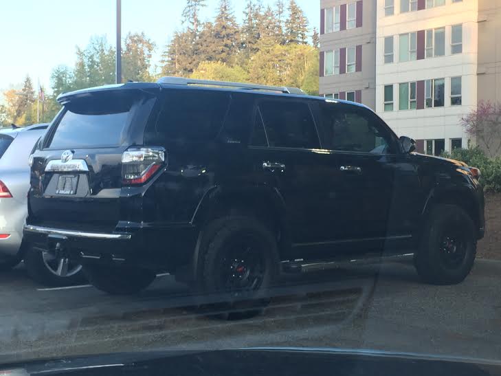

Hey guys - I'm hoping someone can lend a hand here. I have a 2012 Limited at home that now belongs to the wife and am looking at picking up a 2nd 4R. A really nice '15 just popped up at a local VW dealer that has a dealer installed lift on it. My belief is that it's just the Toytec spacers but I'm not sure. Can anyone tell from these pics what is on there? I did call the parts department of the original dealership and they said all that they could confirm was that it was from Toytec. Just want to know what I'm getting myself into and any potential issues down the road. Sorry for the crappy iphone pictures. Thanks!

I did confirm that they are just the Toytec spacer kit that were installed at the dealer which should be fine since 90% of my time is spent on the road. Thanks for the input.

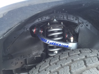

Hey, can anyone help identify this lift? I recently purchased a 2010 Limited, and the dealer says its a leveling kit.
From what I can tell, the front has a 1.25" toytec spacer, but the shocks look after market, and it seems to be sitting higher than just a leveling kit.
