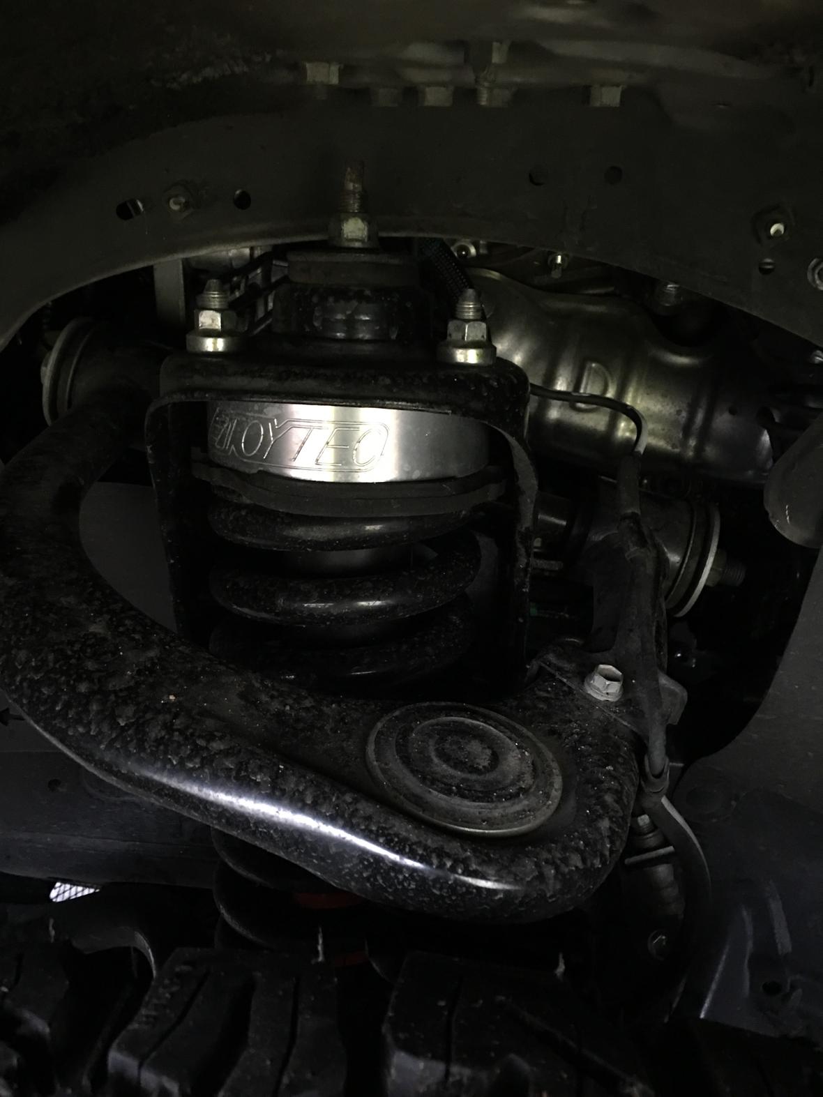

I'm new to this site bare with me I bought a new 2016 4Runner Limited a couple week ago n decide to install toytec 2.5 spacer kit do I need the diff drop kit also and do I still use that black rubber piece that goes between the spring and top hat the reason I ask is that after I install it n took it to get a alignment at Toyota they told me I need a diff drop also I need to remove the rubber piece n reroute my brake line any of you guy done this kit before?

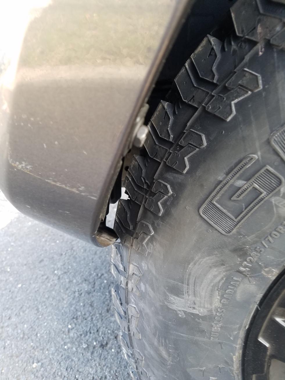

The rubbing is coming from the backside of the tire. Not the front for the fender. Is there anyway to move the tires forward into to front fender more?
Hi guys.
Just installed new nitto ridge grapplers 285/70r17s. The tires rub about 3/4 through a turn. ...HELP ME SLEEP PLEASE
You need to do a fender liner mod. Google it. essentially you remove the bolts on the fender liner, push the liner forward. drill some new bolt holes and reinstall your bolts. then shave off the excess inner bumper.
takes about 15-20 minutes. you'll still rub at flex and lock in reverse, but it will be driveable.

This was mine after I pushed the liner forward, got 285/70/17 general gralbber at2's. I trimmed the liner at the tire shop before driving it home; stock height.
