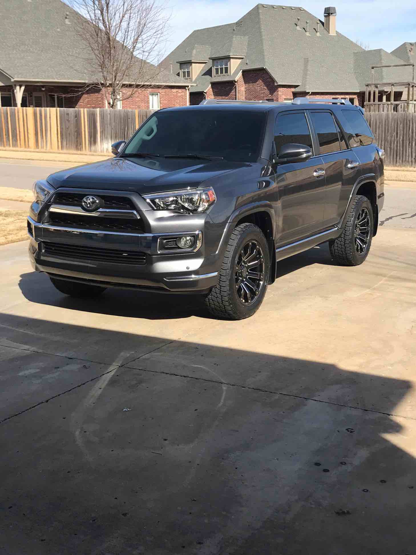

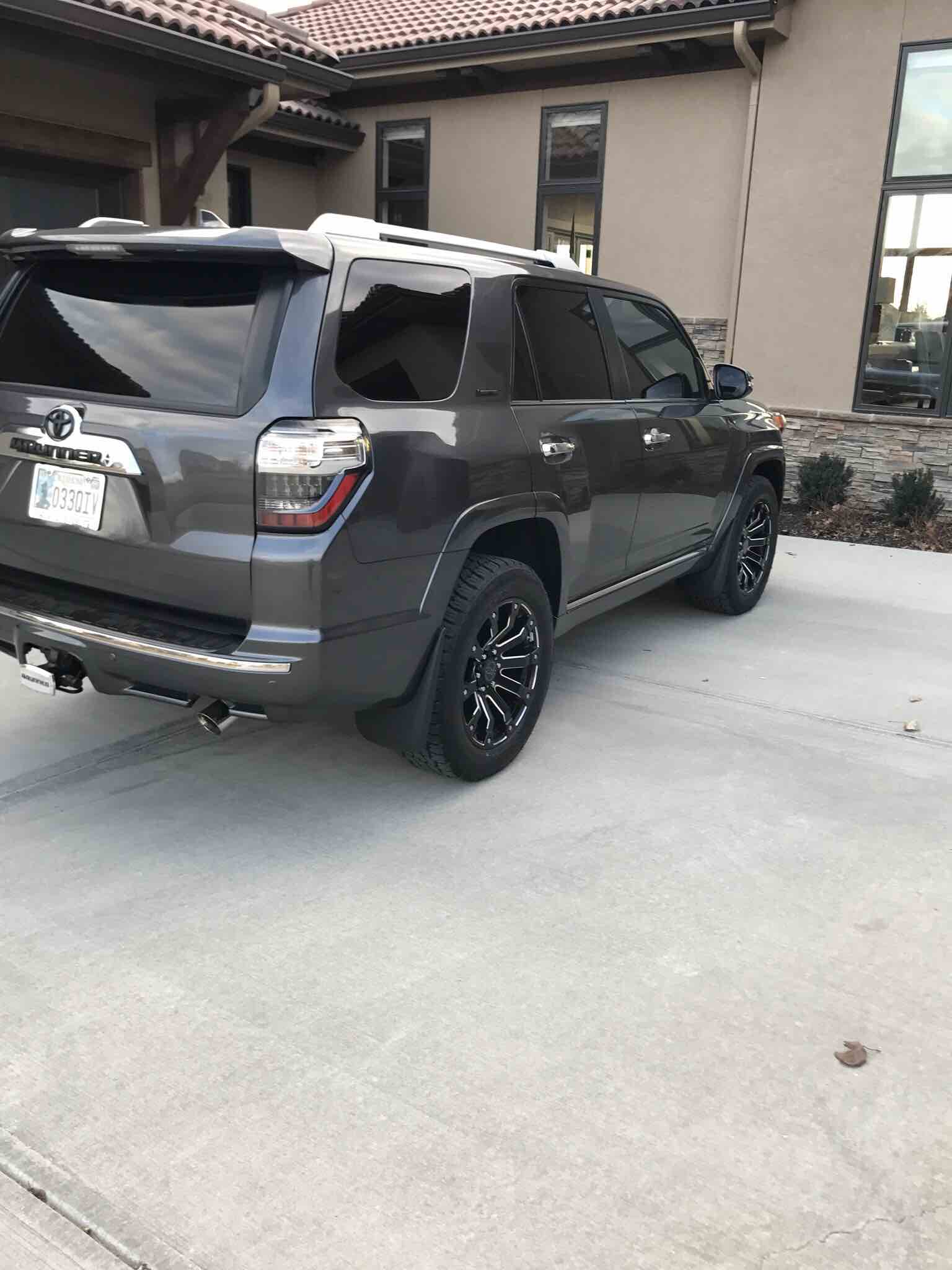

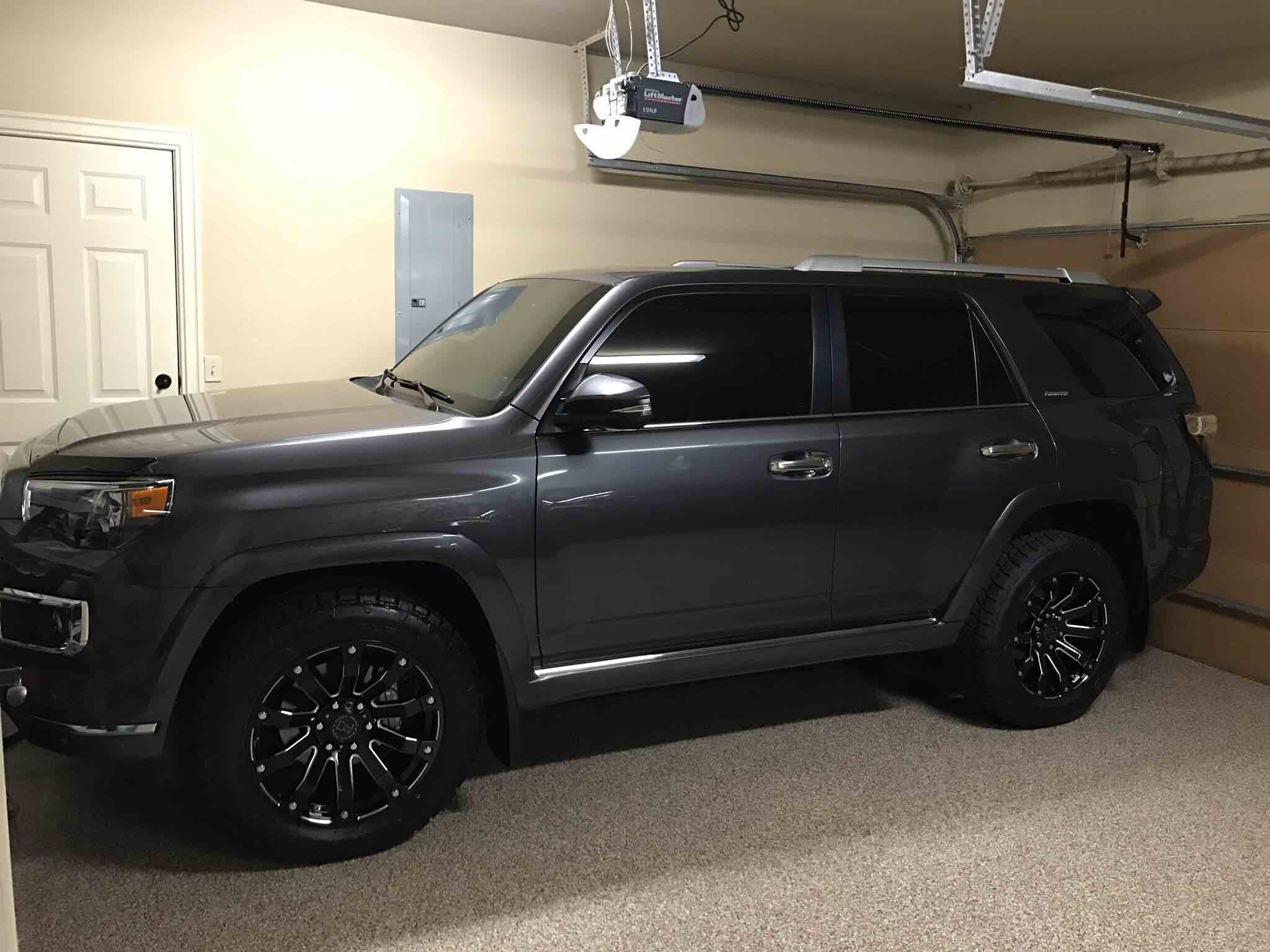

Oh boy here we go. I will preface this by saying I am a complete newbie when it comes to lifts,leveling etc. I read this whole thread and searched( maybe not correctly) but am confused.
So I spoke to a rep from Toyota he today. My simple question was I want to keep my Xreas lift the front so that it sits level and matches the back , a nice clean look. I have a 2016 Limited Edition. I gave him all my this information. He states that my only option was front spacers. I gathered that from the info I have read from this forum in particular the 5th gen lift link. He tells me that according to his measurements (I assume he is reading a stats sheet) that my 4Runner sits 2 inches higher than the front. So he recommended toytech 2" front spacers. So I had him order them. Now I have doubts since many posts have said that it isn't an equal 1:1 ratio. I'm concluding that if he sold me 2" spacers that the front would be raised higher than the rear then? Right? The part number I got was #22953. Item number TAC2 according to the invoice.
Can anyone help a brother out please. So much information for me to digest. Did he order me the correct spacers for the front?
Again I apologize for the stupid question. I just want to know if I should trust this guy with his calculations on what I want to achieve.
Please help me.
Thanks for any responses.
Her is my ride as it is now.
