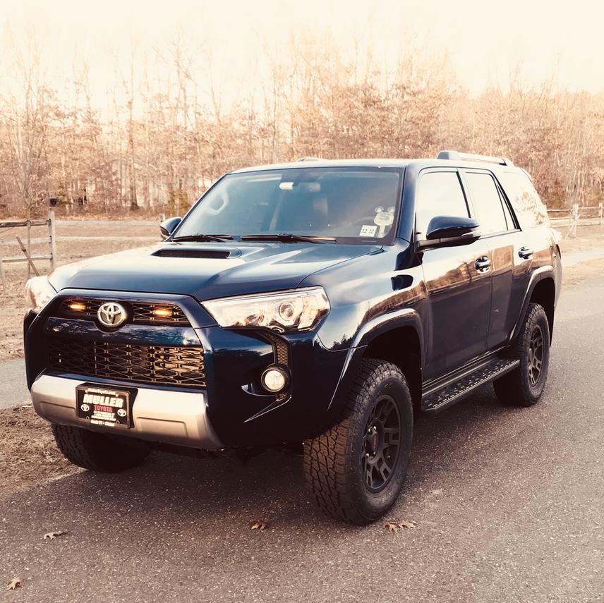

I just a 2011 SR5. Just got some 275/70/17 KO2 over black friday. Lift is next. Thinking ICON stage 2 with light racing UCA. Will mostly be highway driving, fire roads and occasional offroad. I live in Colorado so im sure ill explore and discover more offroad destinations and visit MOAB a few times. Anyone ever run the ICON stage 2? Thanks

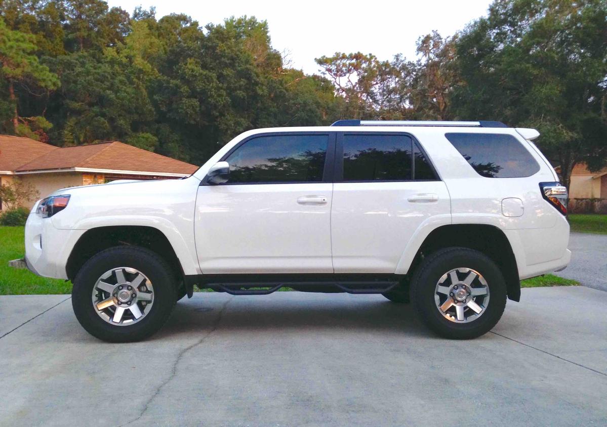

Trd Pro with Toytec 2inch lift. Swapped out Rear coils for Dobinsons for load
I just recently made a rear spring modification to handle some additional load when camping traveling etc.
Current setup:
2015 TRD Pro
CBI rear swing out
Sleep rock sliders
Front Runner full rack
Toytec 2" TRD kit (Front Spacers and superflex could in back)
With no extra weight I am 22.5 inches in front from center of hub to bottom of fender. In the back I am 23.5. Which goes the appearance of pretty level. I had not measured with load but I am assuming 2-3 inch sag.
Extra weight: (give or take 150)
150 lbs labs sit in back area 150lbs.
250 lbs on top rear of Front runner rack
150 lbs back seat
200-,250lbs for CBI rear bumper and tire
150 Tepui XL rooftop tent

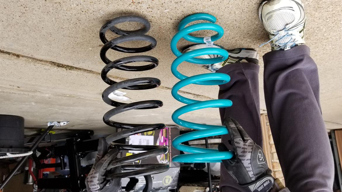

I recently posted about getting new springs and was directed to Dobinsons. I called them up and Dave there spent time to talk through the setup and suggested Springs to replace the Toytec Superflex. The Toytec 2.0 Superflex are rated at around 10% over factory.
Dave suggested the Dobinsons C59-329 spring which is a linear constant Load coil rated at 660-880 lbs.

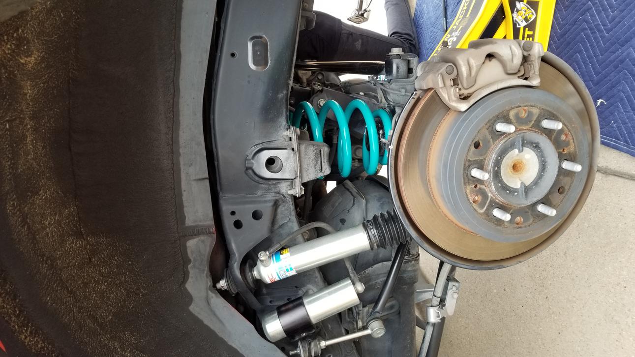

With the springs out sise by side you can see the superflex is actually about 1.5 inches taller but coil thickness is not as thick on the Toytec Superflex 2. (See pic)

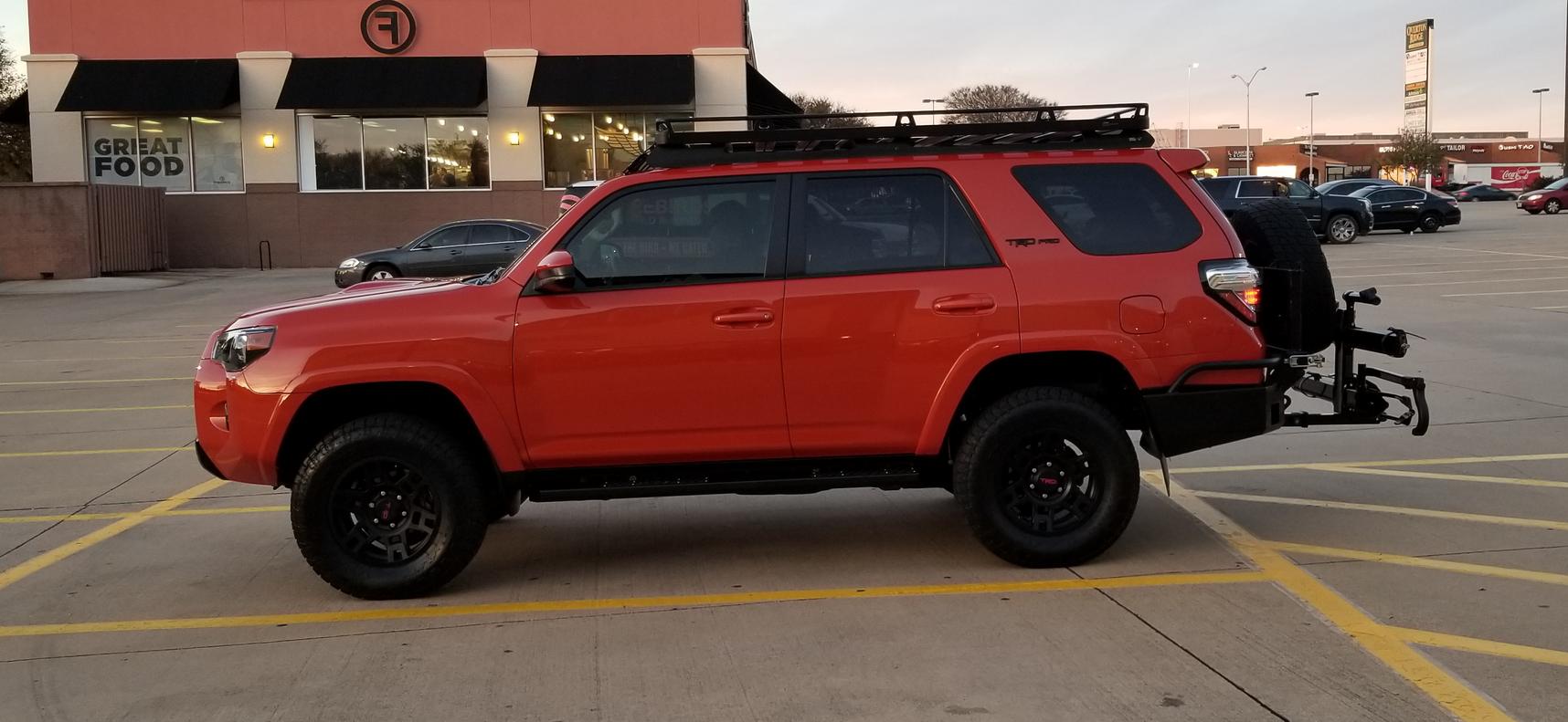

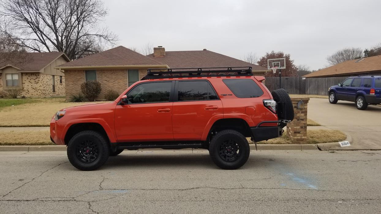

After installing the new Dobinsons I have a pretty significant rake. 25.5 in rear as apposed to the 23.5 from the Toytec. I would like for them to settle about an inch if possible. I am going to fully load it up today to head to Colorado and will take measurements again.
The overall ride with the heavy springs is almost unnoticeable at this point compared to previous. Feels a bit stiffer but not bad.
I can't say enough positive things about Dobinsons customer service so far. Very friendly, professional and a ton optioms. If this coil setup does not work I can swap them for something else. Thanks again Dave for the help on this.
Here are some pics (all without load). The level shot is with Toytec.
I will update post when I get some load on it.
