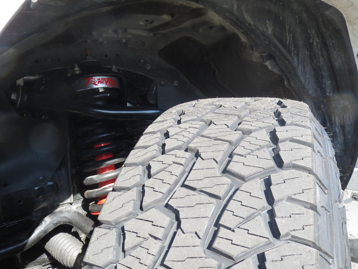

Has anyone used the Revtek 1.5" front only level with xreas? Or have another suggestion for a 1.5" front level? I want to use one that compresses the spring, not a top mount spacer. I'm not changing height to use larger tires, just want less rake. The only shop near me that will mess with xreas will only use a Toytec 3x1 leveling kit. They told me it doesn't work with xreas, I showed him the Revtek installation directions which show how to install with xreas. He again said it won't work. I just moved to NW Arkansas, so I may be missing shops that'll do it. Any suggestions would be much appreciated. Thanks
Yes it will, Toyota dealerships in our area do them so do good shops. In our area there is Les Schwab tires, brakes and shocks who did mine. Basically they compressed the springs in place without disconnecting the Xreas lines on shocks.

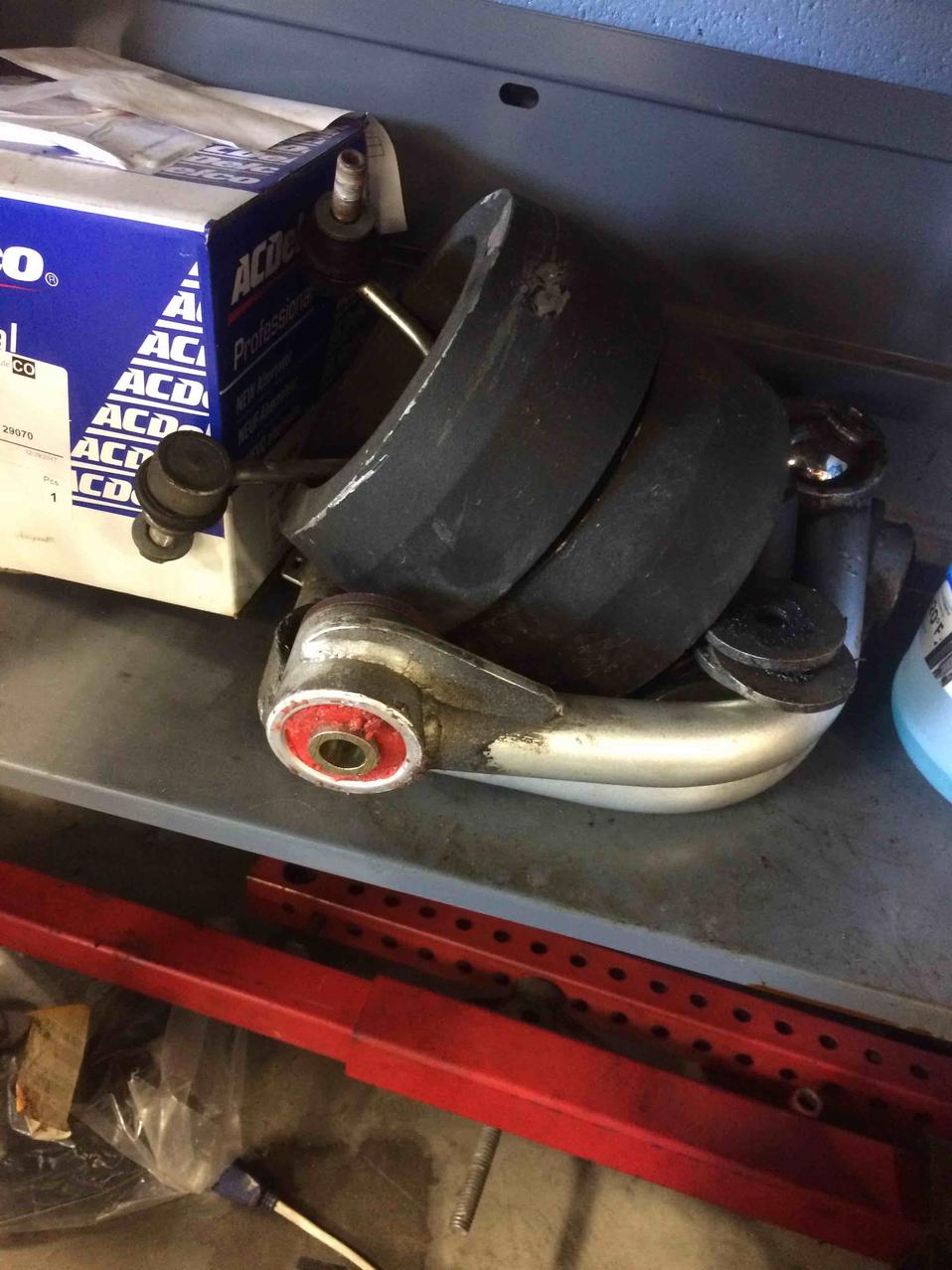

Does anyone what kind of spacer these are? It's used but he said it came off of a nice 4runner and they are steel but selling it at a great price. Said it's a 2.5/1 lift.
