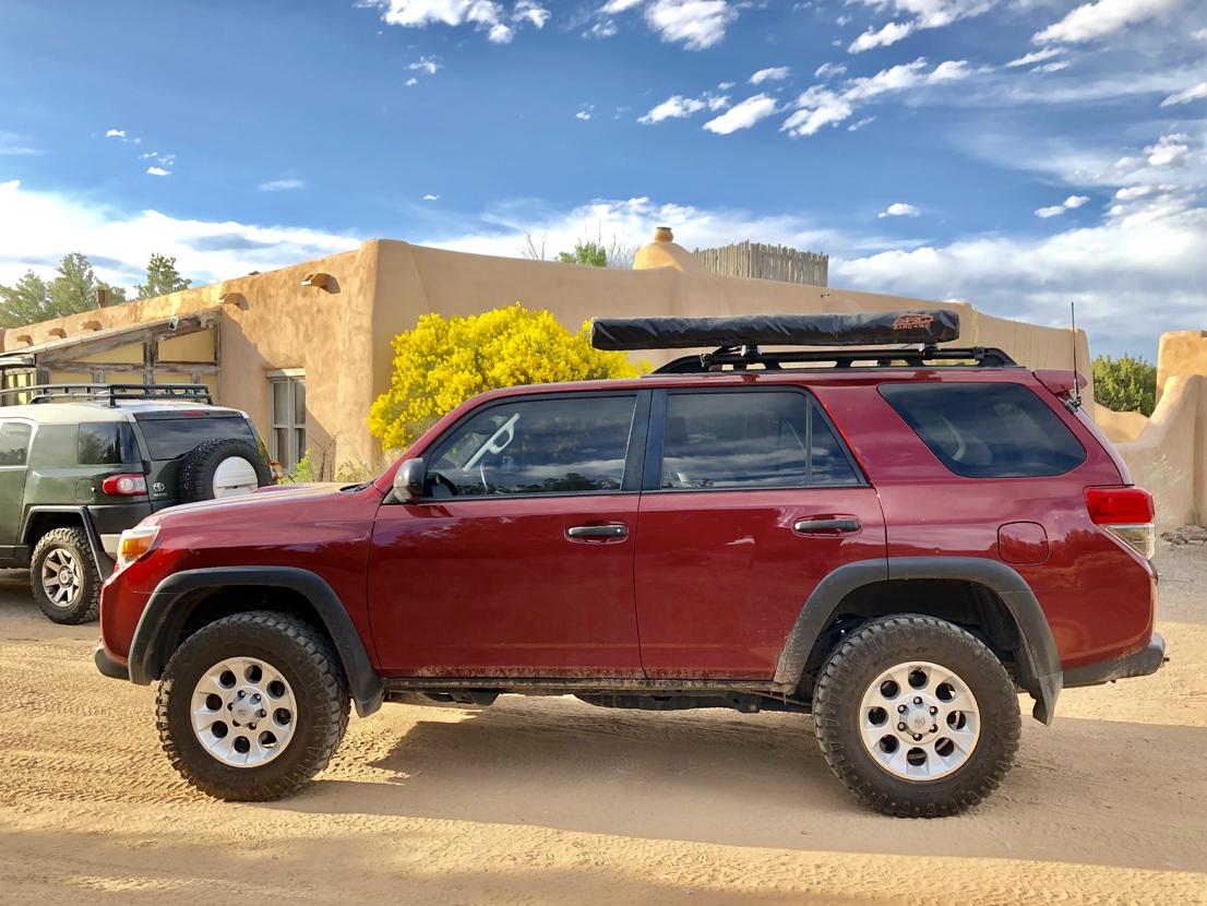

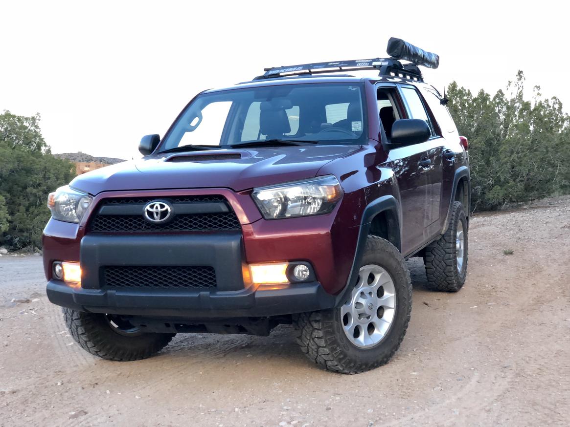

Another data point...Bilstein 5100 set to 1.75” and 1.5” rear spacers with stock tire size.
